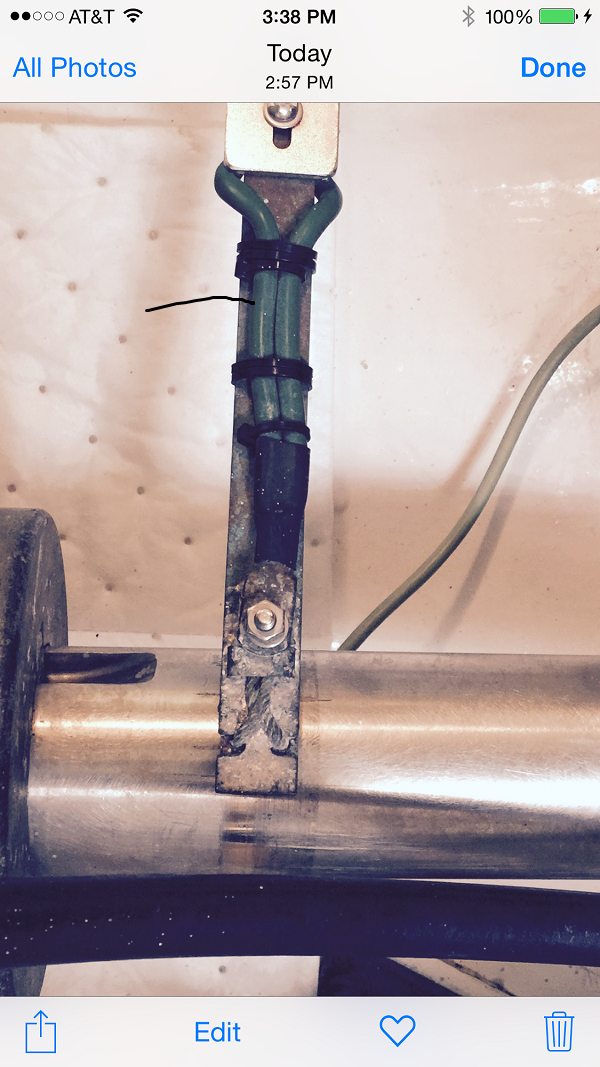

    Capt J found some from ProMariner Shaft Brushes although I am not sure how the green grounding wire connects to the actual brush. On mine (Cabo) it appears the two green grounding wires are made into the brush. Will try to post a picture.

    Here is a picture. Best I could do. You an see the wires that appear to attach to the brush.
  6. Capt J
    14,530
    Ward's marine electric in Fort Lauderdale stocks a lot of the different ones. You might want to email them with the picture as they'll be able to I.D. it probably instantly. Most of the ones I've seen are a bar or chunk of bronze and the bolt that goes through the arm is what the wires attach to. Some of them you have to buy the entire arm, most you can just buy the end......can you take a picture from the side of it?
