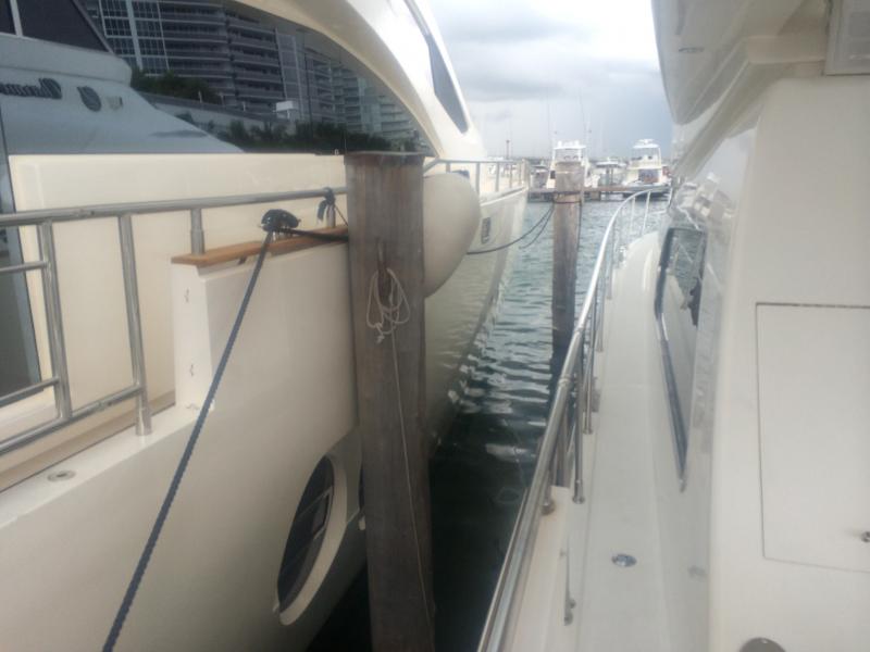

    I guess the stylists over at Aicon have not spent much time on the boats they design considering this useless "recessed rub rail"
    If the fender slips when the current switches or the wind shifts, you call the gel coat guy and write a check!

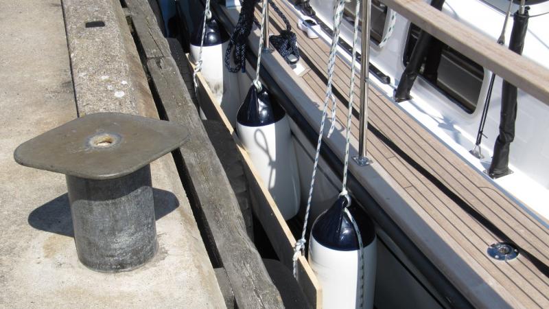

    Has the skipper not heard of fender boards? We have to use them quite often over here with our 30ft tides twice a day.

    Fender boards on a fancy MY? Come on... Not down here :) they're for sailboats and old trawlers :)
    Seriously a solid SS rub rails works great on those pilings we have here. Builders wanting to sell boats in our market need to adapt
    ironically there is a smaller Aicon on the other side with a rub rail. But it s hollow and all beat up!

    I think all boats should have a real rubrail. One that you can pivot off of a piling if it is really windy or for situations like in the picture. Without a rubrail, it makes safely docking the vessel much harder in adverse conditions and you have to really rely on your mate or possibly the owner to put a fender in the right spot and not get their arm caught in there. Not to mention it can be dangerous just relying on a fender, several years back a mate was putting out a polyball in the Welland canal and the boat pressed up against it really hard, and the force shot the plug (where you put air into it) out and into the mates head and killed him instantly.

    I don't see any rub rail in the OP pic....

    Pretty sure that he is referring to the little metal flashing under the wooden cap rail. I think he was being facetious.
