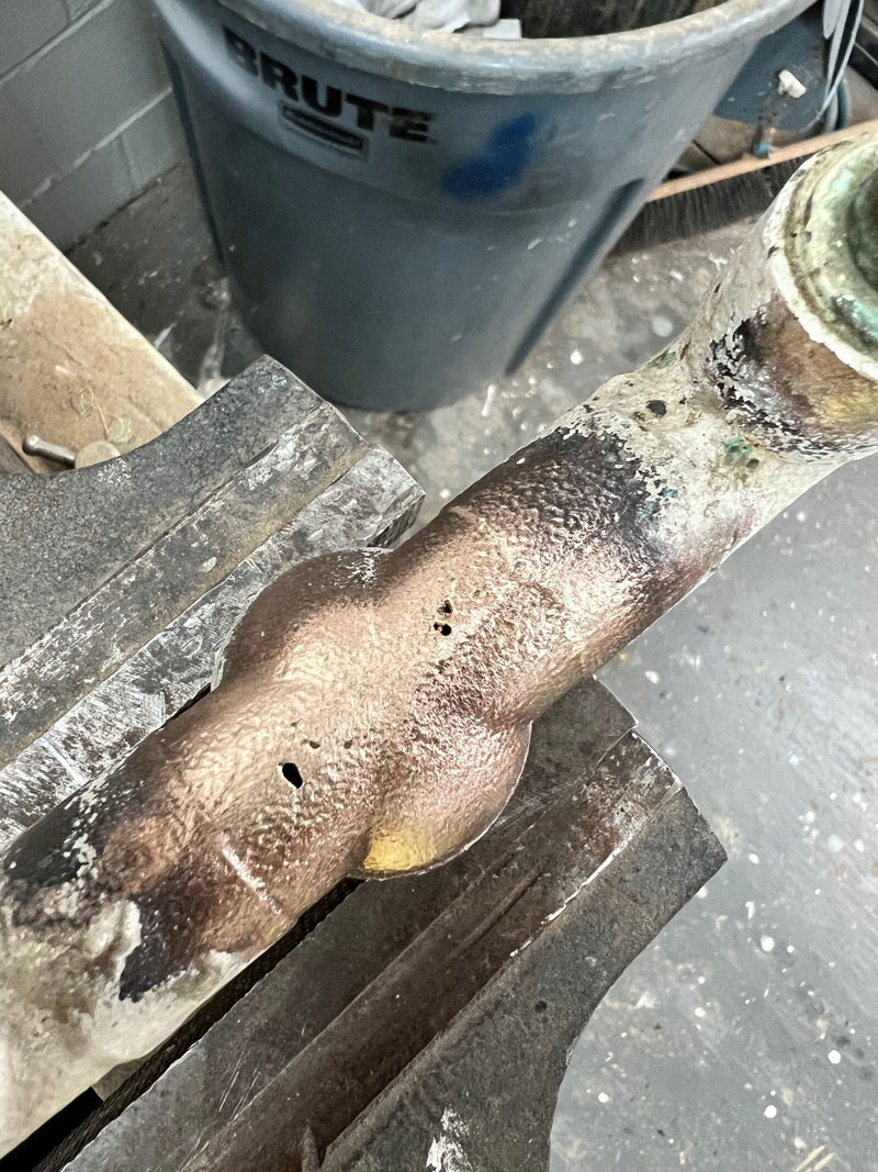

    On a recent short cruise, I went down to give the engine room a quick check. I saw water spraying on the ceiling and found the raw water manifold for the air conditioning condensers had developed a leak. In this case I caught it before any bilge pumps even turned on and before bilge alarms. The wall of the manifold had gotten so thin you could easily push a nail through it.
    I am in the process of adding ER cameras. I likely would have been able to see it on the cameras.

    This manifold looks pretty nasty. What is it made of? Brass or bronze?
    I have seen cruisair or Scott pumps bronze head eroding to paper thin and popping a leak
    I don’t like bronze head pump and for manifold I prefer nylon fittings or schedule 80 PVC

    If you didn't clean the paint away, it could of lasted another few years..
    HA
    It is truly amazing what mixture of brass and monkey metals mfgs put into our bilges years ago and still today.
    Cameras and daily checks are surely how to stay on top of things.
    Glad you caught this before,,,,,,,

    It was made of brass and what's left is very heavy. It was made by NIBCO. I made a manifold of copper just to get me through until I can get a proper one. I'll find something better.

    I have been using Nylon or Marlon for some water manifolds lately.

    Whatever the material used, there is still going to be something that fails along the way. Whether it is the joints, elbows, hoses. Nothing beats regular & thorough checks.
    Well caught.
