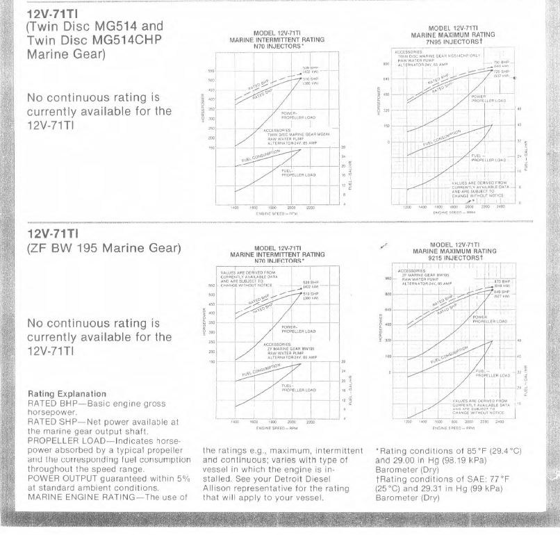

    Here are some GPH charts for the 12V71TI.
    at 1200 RPM you are burning 8gph and at 1900 you are at 30 gph. I have flow scans on my boat and that pretty darn close where I am at.
