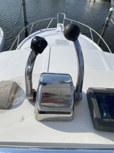

    I have a 1997 Luhrs 360 open, the upper station control box for the gears broke, not the cable, the box itself. Does anyone know where I can get a replacement for it?

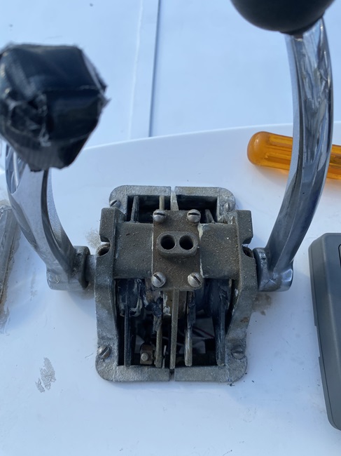

    Teleflex or Morse mfg?
    Send us some pictures and we can help ID the mfg and model.

    I'm not sure if its Teleflex or Morse, there is nothing on the box indicates the brand or model. I am trying to send a picture but it says the upload file is too big. It's just one picture?

    Not an old Kobelt head.
    Not a Morse S head.
    Almost looks like a Morse SR head but not.
    Pretty sure not Panish either but I have a later Panish set in my shop, I'll look at one of them.
    Where are the cover screws located?
    I'll look thru my stuff later today. Maybe another YF kid will recognize it.

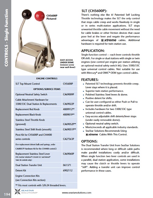

    Think I found it in the Dumbetic catalogue.

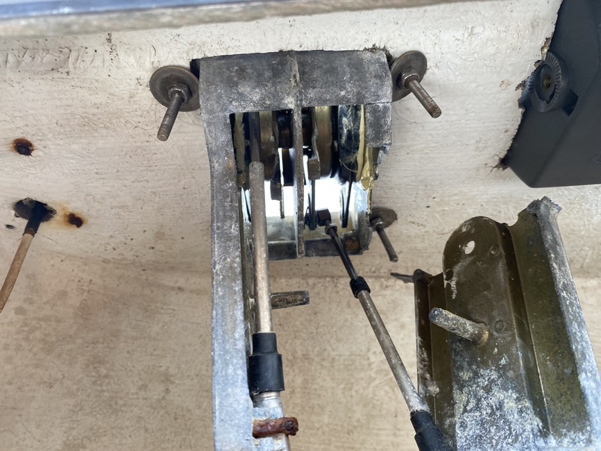

    Only view of the bottom I could find.
