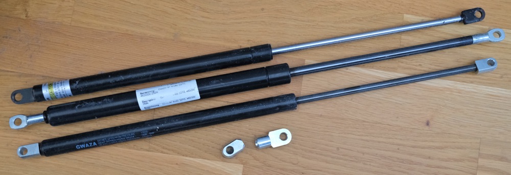

  12. AMG
    5,380
    I had a similar problem on a Swedish boat and thought it could not be so hard to find the right part. The top one on this picture was the original, the next was too long when compressed, the third had a too long gas tube. Not until the next did I get it all OK, the pressure, total length, length on the pieces, the right end fittings and also the tube diameter had to be correct...
