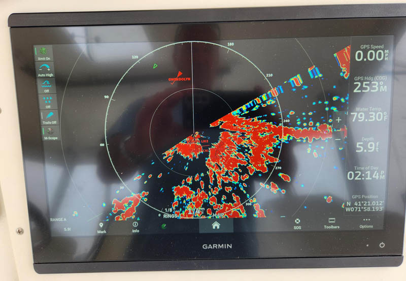

    I have a new Garmin Fantom 126 Radar (6' array 25GHz) and after a routine software update I have now lost approx 50% of my radar image on all of my MFD (2x 8416 & 2x 923). Has anyone experienced this and found a solution?

    Can you post a picture of the screen ?

    Routine?
    So you may still have the previous version to restore to? Please try.
    If not; Warranty exchange or return for service on it.
    I have updated later RayStuff and Simrad just to have them roll over with weird things and die.
    Return for service required on them.
