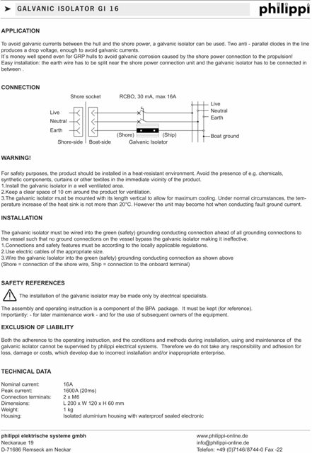

    Galvanic Isolator
    Below an example for the installation of an galvanic isolator. The brand is not important, but the warning and installation advices are nice. I would combine this installation with an indicator for correct polarisation (of the shore cable) and a soft start, to prevent early tripping of very sensitive breakers. Also for a metal hull boat, I would install an indicator for the warning of "current on the hull", as the fault can be in the boat (Especially, when you do a lot of work on your boat yourself :)). All this stuff is available on market and very easy to install. Here in Europe, the Dutch company Mastervolt is one of the biggest player on this market for normal sized yachts.
