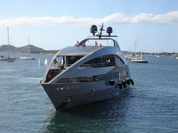

    I know this boat has been here before somewhere but it's worth a repeat. This thing is so ugly it doesn't get any better going away!

    It could have been worse. They could have removed the arches and made it truly ghastly. I wonder how many people will get their backsides cauterized when they try sitting on bare metal on a sunny day.
  8. K1W1
    7,427
    Where exactly do you see the bare backside burning metal on it?
  9. carelm
    carelm Senior Member
    Feb 5, 2011
    403
    fairfax va
    The top picture looks like three people are sitting on the roof just forward of the flying bridge. However, the picture isn't clear enough to make out any sunpads if so equipped.
  10. NYCAP123
    11,208
    I wouldn't expect to find sunpads there, but doubt they'd be there if it were scorching. However, if the captain throws it in reverse they may have one heck of a slide.:eek:

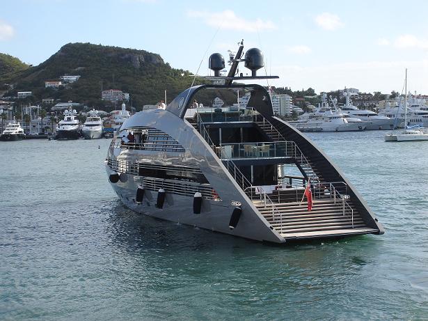

    well, i had the chance to view this boat in monaco. i do not want to comment whether she is ugly or beautiful; as this is a mater of taste. we have a saying in turkish "the baby crow is the most beautiful to its mother"; so who knows what mr foster thinks...
    however, i want to comment about some design faults, which are mere facts. will start to share my observation from the flybridge.
    1- yes these people are sitting on the "roof", because there is only a cresent like settee looking aft and the bulwarks are so high you see only the arc, nothing else.
    2- bulwarks extending to the fly; arc next to the stairs from the aft until the flybridge are slopped in such a way, when you walk next to it you hit your head.
    3- there is a sharp edge glass stair in the salon going down to the quest cabins below; very dangerous to negotiate even when the boat is standing still in the marina.
    4- there is a useless balcony in the master cabin and due to high bulwark you should stand to see anything.
    5- pilothouse is a complete disaster, your view is obstructed and at night you will not see what is around you.
    6- in heavy seas negotiating the stairs to move to the foredeck is dangerous. no proper hand holds.
    my opinion, designers somehow should keep in mind that boat float and move on the water....

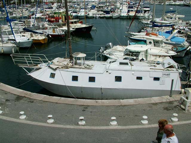

    This could be the winner for today...
    Seen in Nice, France. Has been afloat for quite some time though.
    Some Diogenes Guy seems to live aboard.
  18. Fishtigua
    Fishtigua Senior Member
    Jul 20, 2007
    2,935
    Guernsey/Antigua
    I used to pass that boat every day in Antibes, I thought the darned thing would have sunk by now.
    Oh well, we live in hope.
  19. bernd1972
    bernd1972 Senior Member
    Mar 1, 2011
    305
    Flensburg, Germany
    Oops, you´re right, was Antibes, at the fishermen´s corner of the port. It´s a while ago since I saw it last time (2 years), but then again I´ve seen it afloat 6 or 7 years again and again, never moved farther than the docking lines allowed but it was , surprisingly, afloat all the time. Even right side up. not talking about esthetical value here, but at least something seemed to be right with that "thing".
