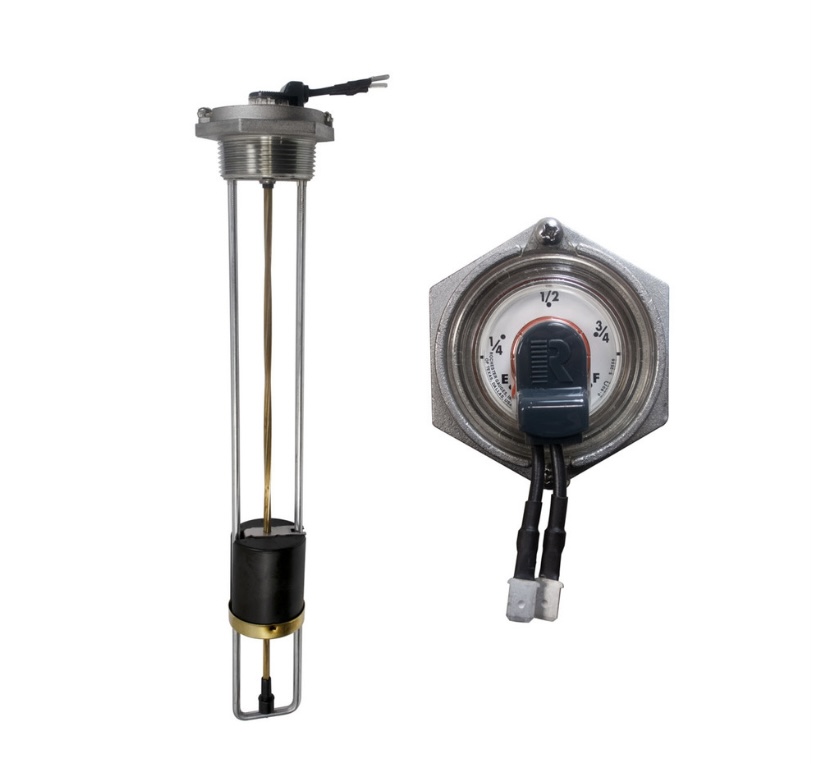

  4. LM Viking
    LM Viking Member
    Sep 20, 2018
    163
    Michigan
    This is a picture of the type of Rochester senders I have on my Viking for both fuel and water tanks. IMG_3777.jpeg
  5. LM Viking
    LM Viking Member
    Sep 20, 2018
    163
    Michigan
    The black float goes up and down and can get stuck. There are other types and brands of senders used.
