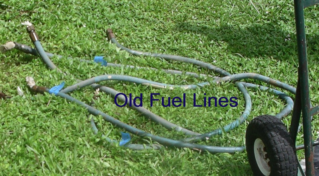

    Once replaced the rubber section of hydraulic steering lines and discovered it had an expiration date. Purchase survey recommended all fuel lines on current boat be replaced (no leaks) and after something happened to a section of one that prevented an engine running off one of the two fuel tanks decided it was time to replace them all, hence the small collection in the making.

  2. Capt Ralph
    13,436
    Save those ends. Expensive and reusable.
    Use bolt cutters to snip off the hose and mail them to me,, if not wanted.
    I'll cover S&H. :)

    Correct the collar gets cut off and a new one used to crimp new hose on the old end.

    The mechanic took them to the hose supply for them to match up new ones. I'll text him to bring them back with the new ones and will send you the cut off ends. Cost me like 350.00 without labor for a short 4 ft. one I had made up a few days ago before deciding to replace them all. Unable to find where the starboard return line goes into forward tank. We can see it entering ER forward bulk head but not on the other side. Suspect might be under the floor, under stateroom bed but really strange as it would be the only line on the boat without any visible access. Sucks not having any paperwork or the long gone Bertram factory in Miami to maybe be of some help.

    I usually just buy the hose and reuse the ends. All lengths are then perfect to the last connection.
    When I re-hosed our Bert, nicer radi in the bends and less strain near the valves. Over all about 10' more hose than factory.

    Previous Bertram tank was fiberglass. Now both tanks are aluminum. Mechanic just removed the last two fuel lines and one had severe cracking so as he said, they needed to be replaced.
