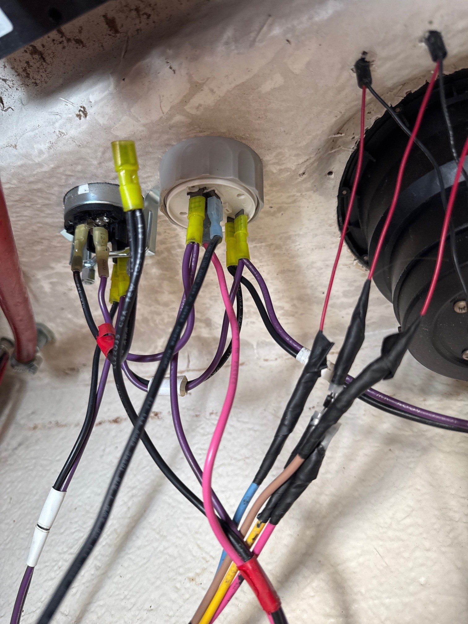

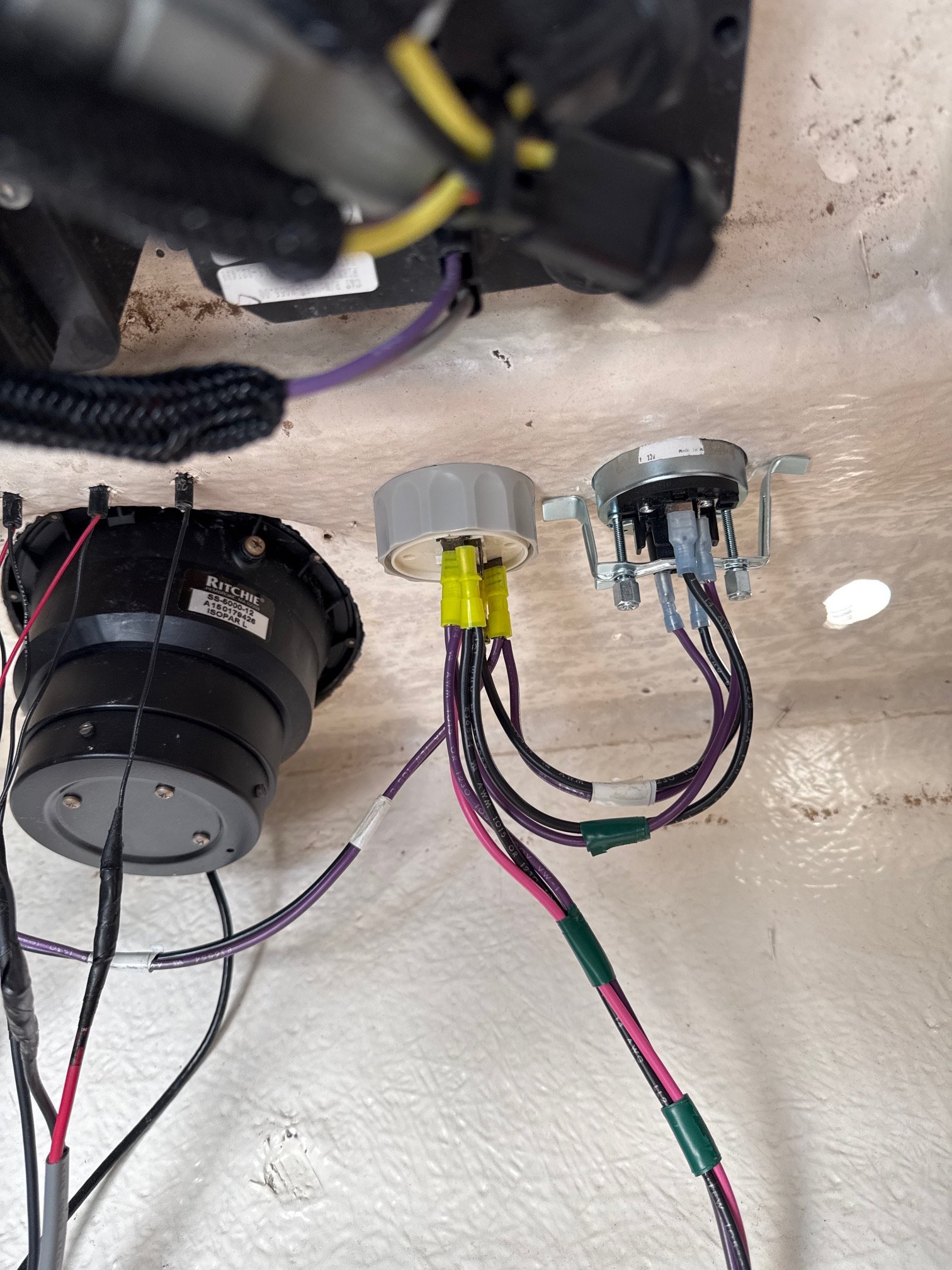

    I attached photos of the back of my gauges, they are daisy chained to the volt meters (fuel gauges have yellow terminal connectors). On the second photo you will see the ground daisy chain disconnected, I connected a ground directly to gauge to bus bar to do some testing.
    Here are my findings.
    Port - sender wire connected, ground removed gauge reads empty pegged, connect ground to ground bus, gauge reads slightly above empty. (I know I have fuel in this tank, its reading the sender on the port saddle tank)
    Starboard - gauge with ground off, sender connected reads full. With ground to ground bus reads empty. But should read full as tank is full and a solid ground?

    Sounds like the gauges are different brands.
  20. rtrafford
    rtrafford Senior Member
    Jul 13, 2019
    1,915
    Vero Beach
    Sounds like the gauges are different brands.[/QUOTE]
    By the looks of the photo they are different brands. He needs to check ohms with a voltmeter to sort out condition of the senders and wires.
