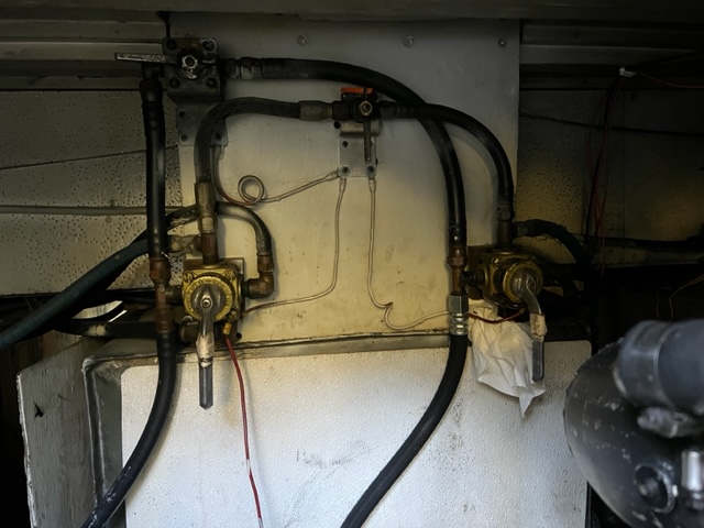

    Question on how to align the Fuel Valves to run Port Engine off STDB Tank.
    Have an issue with Port Tank.
    I believe I keep Port Tank Valve closed and open both Cross Over Valves between the two.
    Current Valves are from Republic Manufacturing.
    see attached pic..

    Looks like two crossover valves (supply and return), should both be normally closed.
    I would SWAG, these crossover valves have been added.
    Time to follow the hoses.
    Label them and update your picture where the hoses go to/from.
    The main valves were probably just supply and return on / off from each engine to their fuel tank, originally.

    Evening Gents,
    Figured it out there just Cross Overs.
    Currently
    Have Port Closed and Running off STBD until I fix my Port Tank
