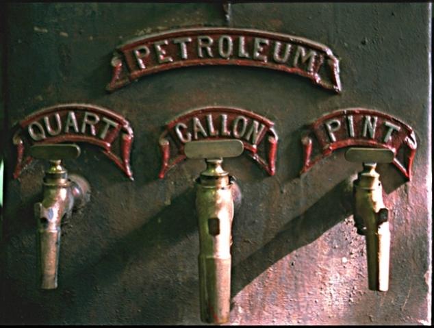

    Gallons
    And be carefull, our American friends are talking about US gallons, which are 3.78 Liter per gallon, whereas you might think in Imperial gallons, which is 4,54609 Liter per gallon.
    Attached a typical Britsh filling station:D
