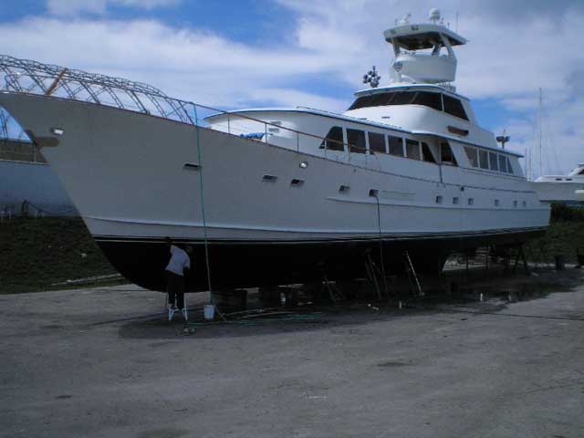

    The only experience I've had with this beast is under tow when we took 4-6 on the beam and she rolled like crazy.Perhaps under her own power she will behave differently. The stabilizers were also not pinned so may have contributed.What concerns me is the height.If I knew how to post pics on this site you would see what I mean

    Wouldn't mind seeing them. On the reply pane click the paper clip, then browse your pictures and download.

    I hope the attachment made it. Am using a new zip programme

    Yeah, I remember that boat. Get those stabilizers working. Now! :D
  12. Capt J
    14,529
    ummmmm yeah, that one is gonna roll with that heavy crow's nest up there. The ones I ran were a regular MY with only a bimini top and mast head. Try keeping more weight in the stern and draining the bow tank first and see how she rides. She does still have a flat stern and if you ride more on the stern it may help quite a bit, although it may slow you down a hair at displacement speeds.
