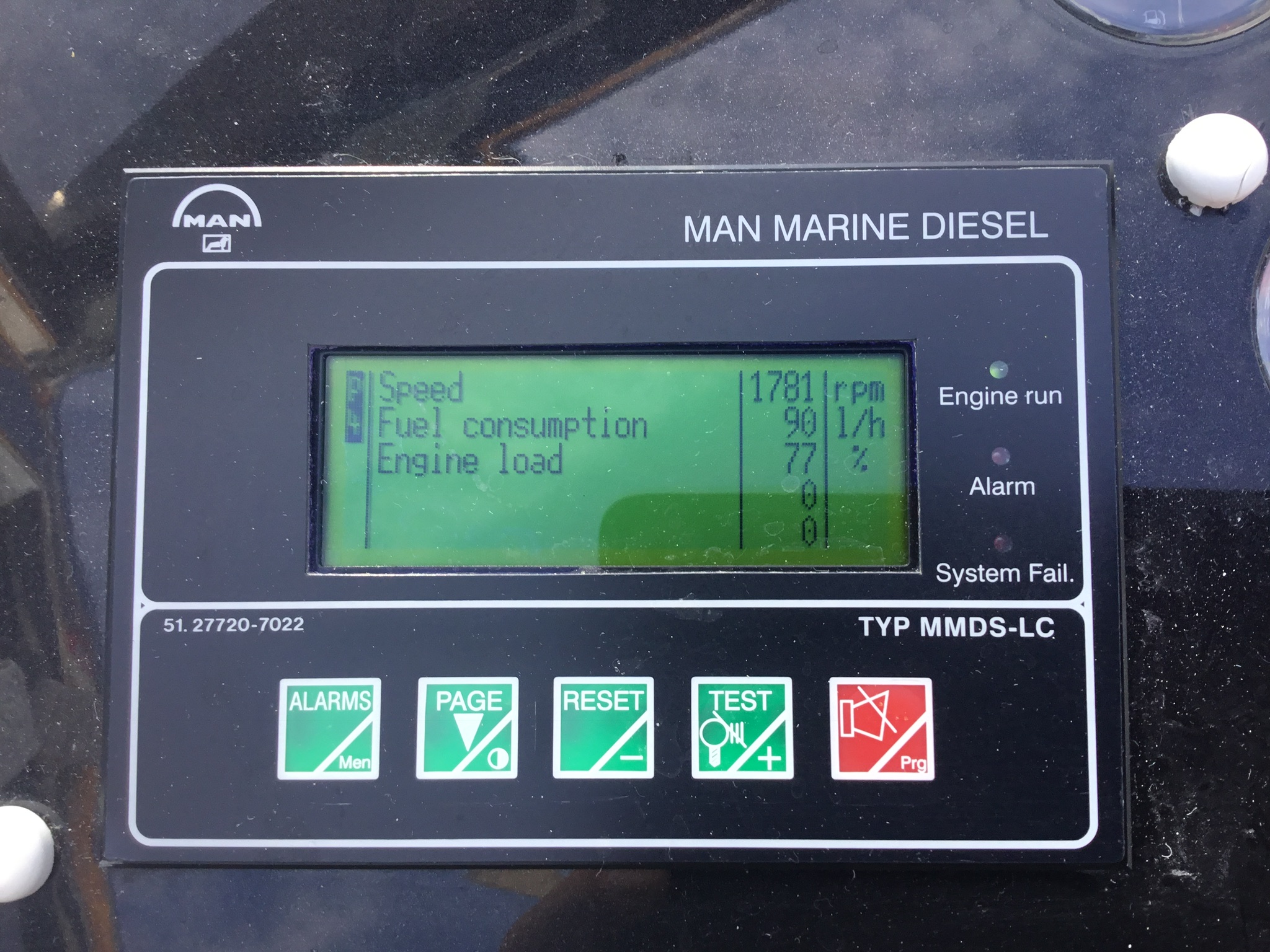

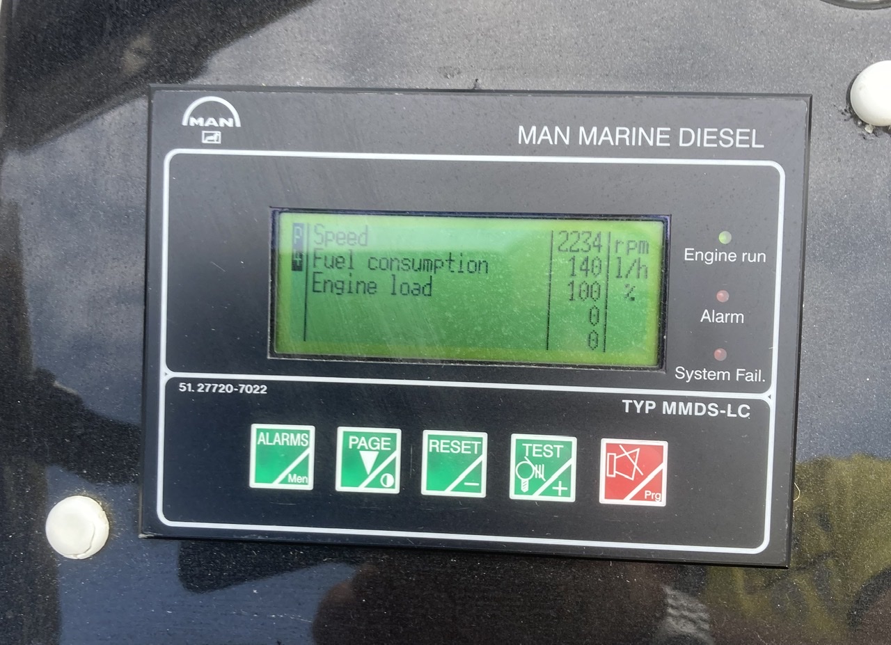

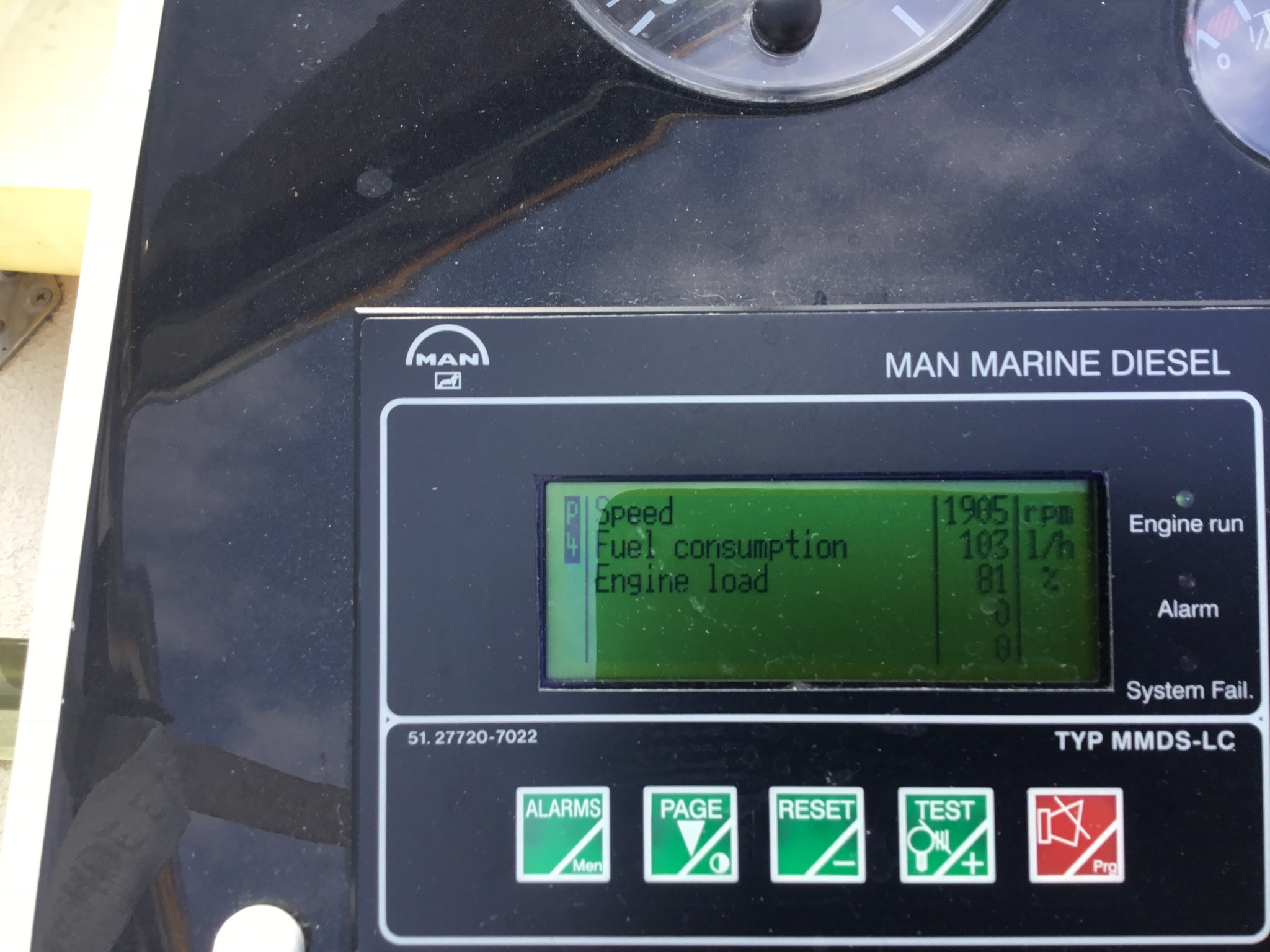

    A fuel hose off would trigger some alarm or other .If it doesn’t then simply lack of rpm or some other parameter would be brought to the helms attention.
    Coincidentally since you mention injector timing I have had a faulty injector sensor ( the only thing btw in 7 seasons taking them from 480 to 1080 hrs ) .Well you get a sensor error for starters and some of the numbers do alter .Alter enough to make it obvious further investigation is necessary.Also a rpm limit is triggered .I can’t remember exactly which .But noticed for example the EGT s no longer sync d .The affected motor switched to a stored algorithm for its fuelling instead of using live data = some parameters on the screen lost there synchronicity.This is when the sensor alarm is shut off .
    So the multiple bits of data fed into the black boxes by the arguable excessive sensors MAN use , then transferred to the screens kinda cover each other .
    I don’t think your argument that Capt J s , mine and others sensors are erroneous when we run our boats and happen to flick about through the various pages on our screens ……fuel burn being one , is validated.
    If they were as I said the boat tells you either via alarms or you see plane differences in the pairing of the parameters.
    For any credibility discussing fuel burn comparisons on boat forums we need like for like independent electronic ( does not matter which the manufacturer has adopted) read from a screen .
    I will add the caveat if I may from fully working engine(s) not alarming off .
    like this below .
    My normal cruise ^ keeping under the 80 % load in the interest of engine longevity.Equates to a 28/29 knot cruise .Or a bit lower with a dirty bottom .
    I can’t exactly remember when this pic ^ was taken in the season ? I have seen 80 L early on in the season lightly loaded .So the consumption does vary sometimes.I suspect this pic is later in the season + heavily loaded fluid wise ?
    A fast cruise ^ 31-32 knots .
    WOT test. Some 3-4 months after it’s annual service / antifoul .
    The rated rpm is 2200 . So pretty pleased with that 20 y old MAN 2876 le 401 s @ 700 Hp , in-line 6 s . Tells me the propping is right .No alarms ( touch wood ) the motors are in rude health.
    I have sight glasses on my tanks with tape from the previous owner marking them in 1/4 increments.I just casually “ sight “ them during daily checks especially if I plan a long ish trip .Yes agree with you partially years of experience tells me you can’t beat the MK 1 eyeball .With electrotwackery there’s always a lurking suspicion it’s gonna fool you .
    But it’s no doubt the best thing , the only way to compare boat fuel burn rates .Well to get any credibility.

    As it is you claim your 16 L V8 s running at or around 1900-2000 rpm ( or what ever ) in a far bigger / heavier boat 56 ft vs theCabo 40 or my 14 m lighter (heavily built granted coming in @ 18 - 20 T depending on fluids carried ) boat with inline 6 s at 40 % less cubes , 2 less pots users the same fuel more or less .It can’t .Worse still burn less fuel typically running .
    Assuming my numbers I have posted and Capt J he quoted ( assuming he can read his screens ) are correct .Also if others chime in with there screen data we will collectively form a hierarchy whereby the Hp , the size ( boat + motors ) , drive systems IPs or shafts , Arnesons , jets etc broadly form industry standard order .
    So others without “ screen “ fuel burn data can make a meaningful estimation where there boat fits in this general order .
    Your calibration must be waaaaaay out .
    Your numbers are outliners .
    Have you never considered that’s the case ?

    Precisely as I mentioned and I think you agreed - manufacturers charts with ave prop demand curves cannot be relied upon .Indeed underestimate the real world consumption.
    The pics I posted show the load which I use around 80 % to set the cruise rpm .The variability of load I see due to fouling / weight etc I can assure you I am familiar with how diesels work .I see it .Also EGTs on a another page .Having screens and watching changes actually stimulates a greater understanding than otherwise .
    It’s still a pity in terms of credibility and comparability of your consumption you cannot access real data from a screen .
    Or your consumption figures fitted in the gen norms / patterns of other 56 ftrs with 16 L V 8 s .
    10 tons heavier ( near enough 50 % more ) and despite my 23 degree deadrise on a 14 M boat your 17 M must have at least 2x under water surface area planing compared to mine . Bigger engines etc older mech injection .
    Mines pretty near the Cabo 40 maybe a 1 M bigger ? .= similar consumption.
    Well closer to the Cabo 40 than your DP 56 in terms of consumption.
    I just can’t see it like the Cabo 40 being close to your consumption or indeed worse as you claimed ^
    For a like for like cruising rpm say typically 1870 , 1900 rpm .It must burn more , possibly @ more “ load“,
    We can never see your true load figures .
    Mine will travel faster obviously which it does , which improves its gallons / Nm .
