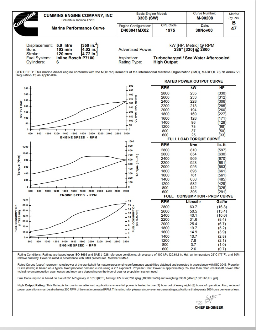

  3. Mark Williams
    Mark Williams New Member
    Jan 3, 2022
    Cottonwood, CA
    Thank you very much for your input. I was able to find this. I am assuming that having 2 engines will have some impact on this but as a rough guess, I am thinking 1100 rpms would be very close to that spot whatever speed that may be? 8-10kts?
    Rougly, @ 2 gallons an hour per side = 4 gph total at ~10kts, which would give me about 2.25mpg?
  4. ranger58sb
    ranger58sb Senior member
    Aug 20, 2013
    971
    Chesapeake Bay, USA
    The charts don't really take into account resulting boat speed -- due to variables like length, shape, weight, windage, etc. -- so that's really only a starting point with only engine data.
    But I'd guess 8-10 kts on a 38' boat would maybe be just pushing water. The formula (which isn't perfect for your hull form anyway) suggests lower is better, or up on plane. In between, trying to overcome your bow wake, won't be great.
    Once you know your real water line length, the formula is 1.34 * SQRT(LWL) and then lower than that resulting number -- often somewhere between 1.0-1.2 * SQRT(LWL) -- is usually more economical. Depending on resulting real-world speeds.
    And then sea states, wind, current, tides, etc. all chime in to impact reality.
    Also, you'll want to be running the engines at acceptable loads/temps; Cummins can probably advise on acceptable upper and lower limits. It's often said diesels run best at 80% of load, or 90% of load, or "200 off the top" (varies depending on pundit) at the upper end... and someplace enough above idle at the lower end to get engine temps into their acceptable range and keep them there.
    -Chris
