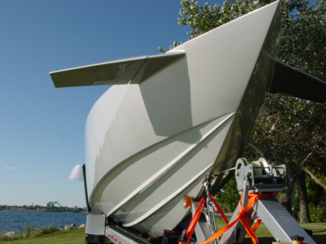

    A canard on a boat? What a cunning idea! Good for you for thinking outside the flight envelope. ;)

    Wow
    That looks so real, but its a mono hull...with wings!!
    Who did it...which racing team? That looks really neat...no retraction mechanism
    so you have the wing in play all the time...that is the most amazing image.
    Thanks!
  12. YachtForums
    20,610
    This wasn't a race boat. It was designed by one of my colleagues as a POC boat for a defense contract in the late 1980's. The canard is active.
