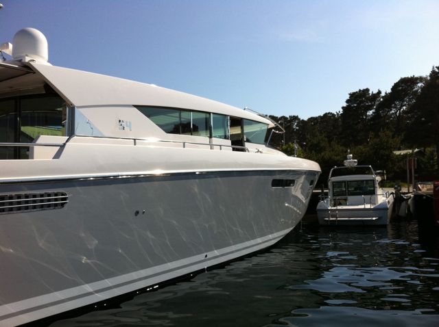

    We have built over 200 boats where the windows are a structural frameless support. On the 34-40-54 we have a side-door for ventilation and for easy access from the driving position to the side deck. It has a supporting steel frame though. Looking up we have big electric glass hatches. I can guarantee you will have a good cross-ventilation at 40 knots....:)

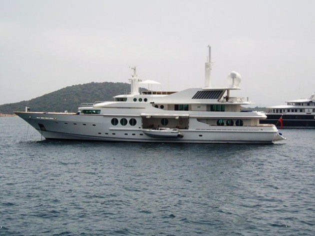

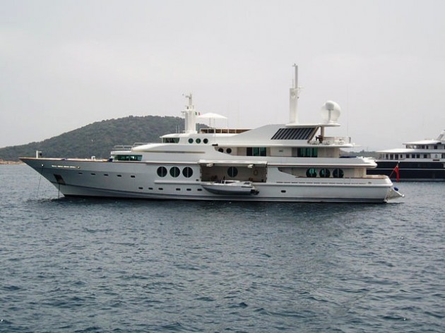

    Just curious, Did you ever confer with Jon B, back in the 80's?
  14. K1W1
    7,427
    Interesting you should post that photo. I have an intimate knowledge of that vessel as I was present during the last yr of construction and first 3 yrs of it's operation.
    Stefaren as she was built is a steel boat with an aluminum superstructure, those nice big round windows on the maindeck there were trouble from day one as were the Obs lounge ones.
    I figured the OP was aiming his question more at plastic boats as the metal construction ones do not need the glass to provide any structure, the metal
    takes care of this.
