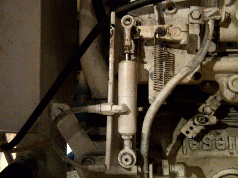

    While servicing the engines (8V92TI) I noticed a piston/strut on the top that is connected to the arm which activates the shut-off solenoid. I tracked the line on top of this strut to the fire system. It looks like in the case of a fire when the halon system is activated the engines will shut down. The strut was not connected and needs to be replaced. I contacted a local detroit dealer and sent them a picture. I have called them a couple of times but it looks like they are trying to figure out where to get the part. They dont believe that this is a detroit diesel part. Is there anyone on the forum that is familiar with this part?
    Thanks in advance.

    Virtually all of the engine room mounted fire supression systems automatically shutdown the engines and generator(s). So they don't ingest the halon or whichever gas and destroy themselves and to assist with fire suppression. A good fire system will also have dampers that close the boats air vents for the engine room.
    As for where to get the piston, look to the manufacturer of the fire system you have on-board. The piston looks to be air powered by whatever is in your fire supression bottle. That is neither a Detroit Diesel or Hatteras Yachts part.

    It is the original Kiddie Fire Supression system. I appreciate the information, this is very helpful and now I know what direction to take.

    Before spending a lot of time and money to replace the cylinder, how about just put some air to it and see if it works. If it does then all you need is a shoulder bolt.
    And as far as the "automatic shutdown" is concerned, make sure that it is indeed automatic and not part of the manual discharge procedure. You may have an alarm, then if and when you decide to discharge the system, engine shutdown is part of that process.
    Read the book. If you can't find a book, contact the fire system manufacturer and have them inspect the system and tell you how it works ... they will also provide you with a manual.
