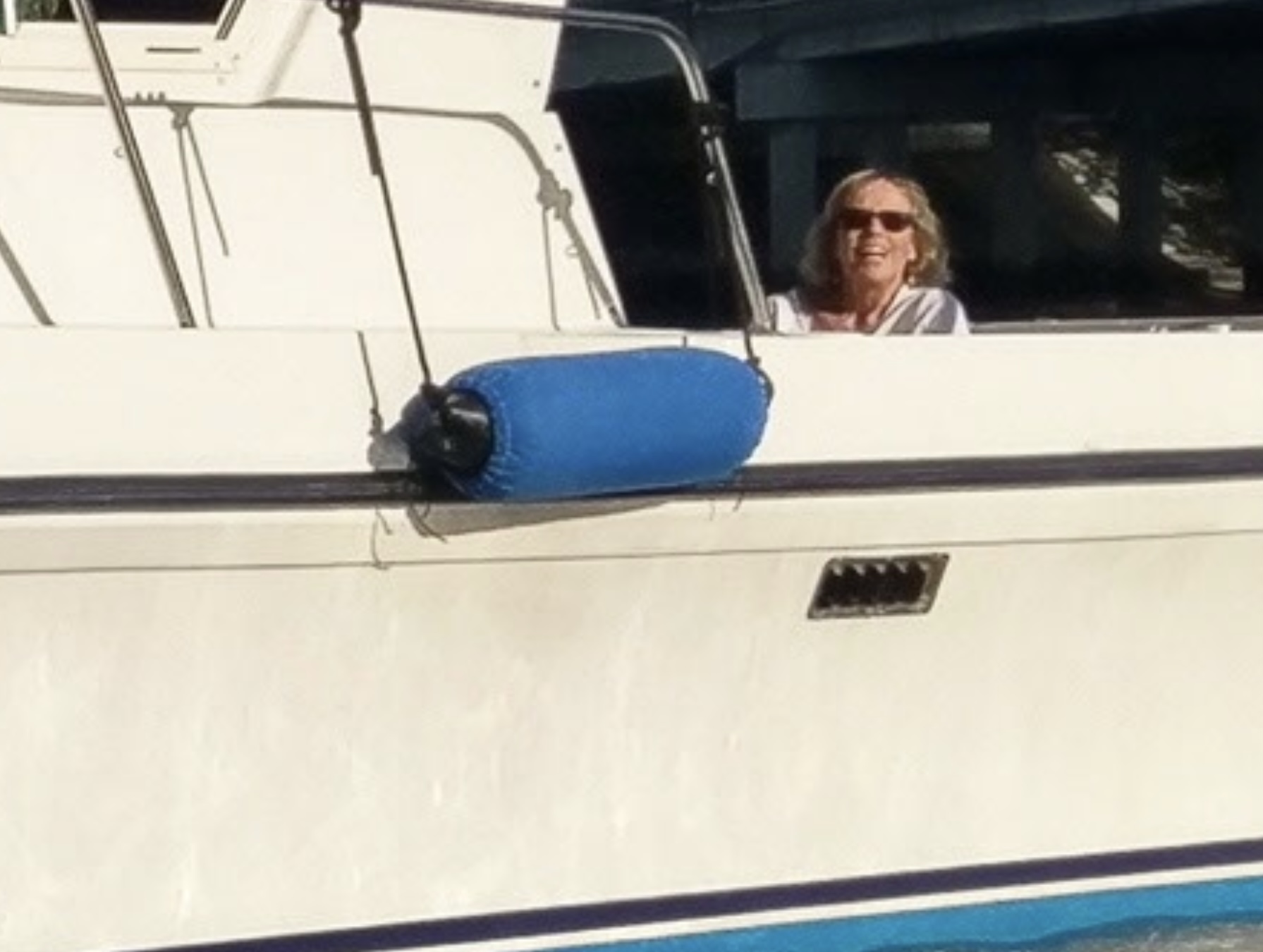

    I have used custom made Sunbrella covers over the years: Works good, last a long time.. IMG_5929.jpg
    DOCKMASTER likes this.

    My old captain, Kenny Argent, used to call these 'Goat Knots'.
    [​IMG]
  19. Norseman
    Norseman Senior Member
    Feb 24, 2005
    3,110
    If you can't do a knot, do a lot..:D
    bayoubud and cleanslate like this.
  20. Capt Ralph
    13,436
    Wha, Wha, What the heck is that?
    I would be embarrassed, run and hide.
    bayoubud likes this.
