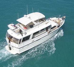

    The aft deck of my Hatteras (see photo next post) is EZ2CY. Wonderful stuff, highly recommended. The center panel folded up and attached to the aft deck ceiling.
    We did this maneuver maybe a thousand or two times, we liked having it up in fair weather and for access to the swim platform / dinghy, and for line handling.
    We managed to crack it at the top, by not fully unzipping the side zipper and not paying attention. Cost us less than 300 to replace, maybe just got lucky with a good canvas shop. I think it was cracked about 6 months before replacement. No water intrusion as it stays tight to itself.
    The visual acuity is phenomenal, as good as glass. Wouldn't think of using anything else for a big enclosure.
