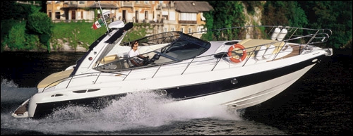

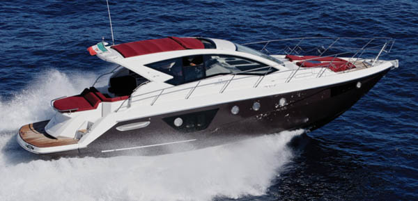

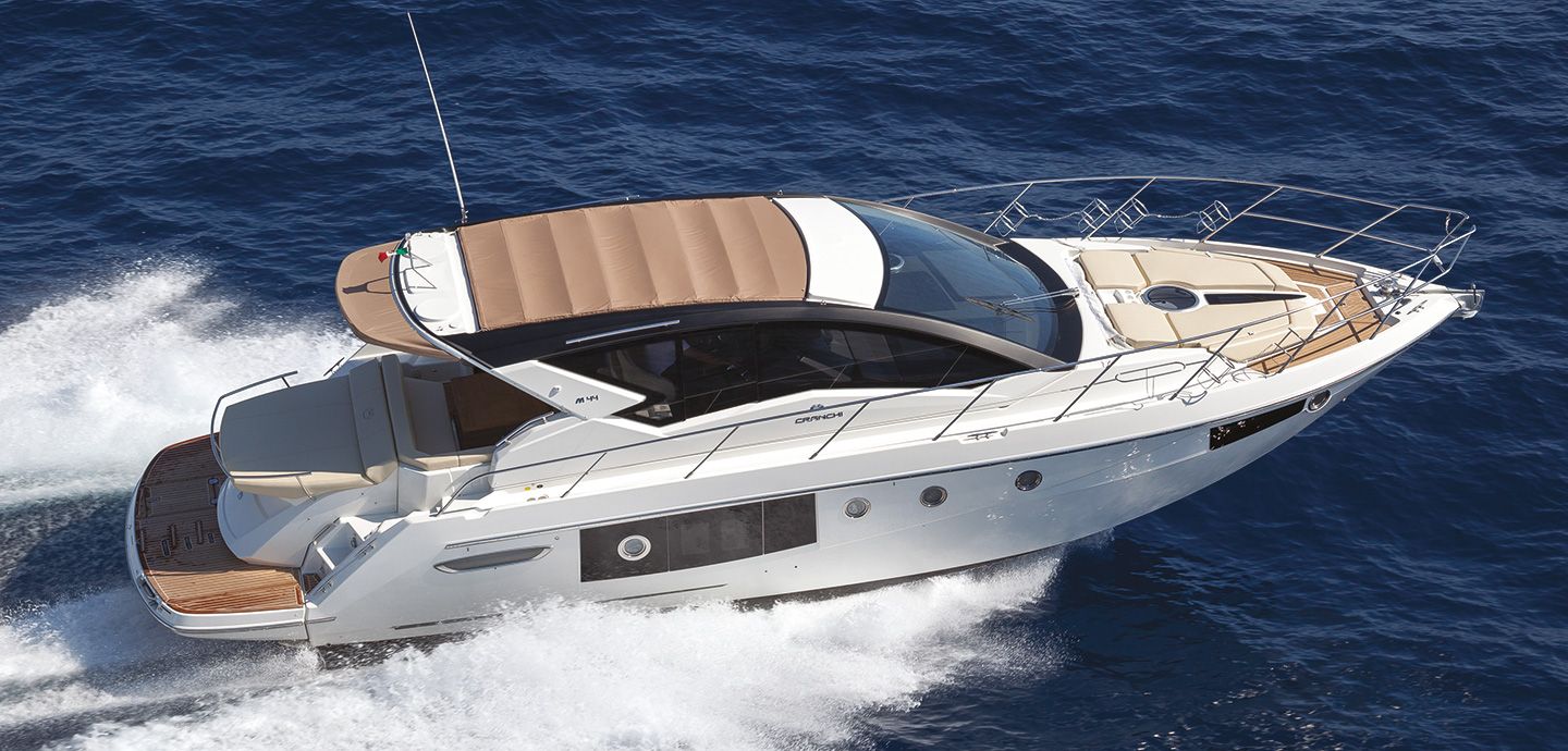

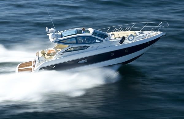

    Cranchi:
    Endurance 41' (open)
    Mediterranee 43' I.P.S. (open/HT) now M44 ST (M40 ST)
    Mediterranee 47' (open/HT)
    Cranchi Shipyard
