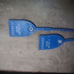

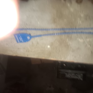

  10. Capt Ralph
    13,434
    Unless you are going to practice with them, what good is old stuff on board?

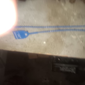

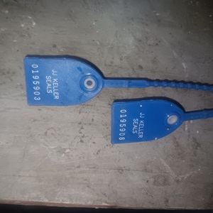

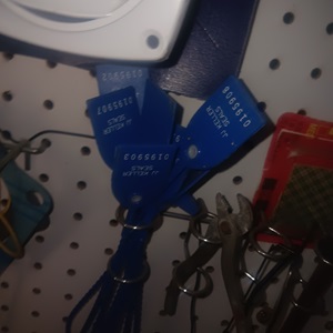

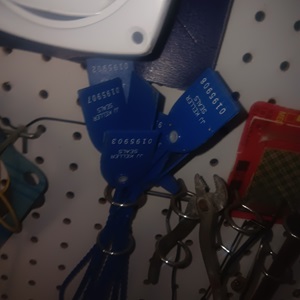

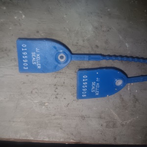

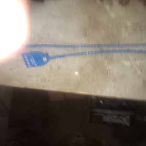

    If you use zip ties with an integral serial numbered tag and this number is in the ships log, you are leagle.
    In the log, when you pump off shore and re-attache a fresh tag, this is also recorded in the log.
    The idea of a pad-lock on the sea-cock is obsurd.
    I remember, on some boats, the black water pump had a electrical key-switch to enable it. This is leagle also. As long as the key is secure and a log is maintained.
    Funny thing, every time we have been boarded, I have reminded the USCG lead that it doesn't mater where the black water discharge is, were 4 miles off shore.
