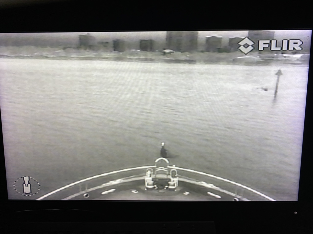

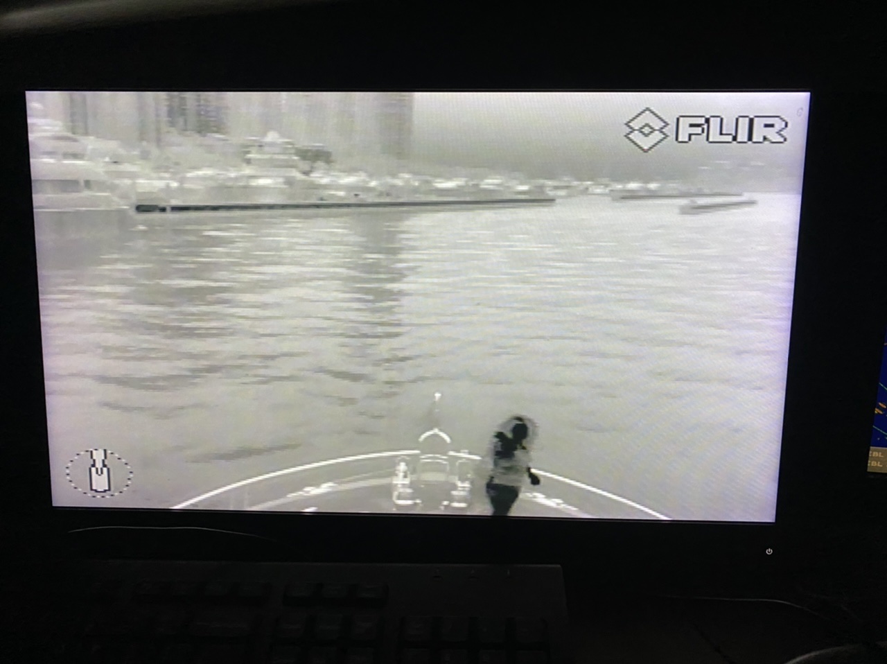

  17. Pascal
    8,932
    9B97750B-2AD0-4AB2-AC77-C0E98C1F851E.jpeg 4129B79A-49C0-4B66-9405-FF8FFED3C6B3.jpeg Here are a few real world shots I took tonight.
    first one is at the dock. The spoil island is about 100/120 yards away
    second one is approaching the entrance to Miami Beach marina, breakwaters are showing very well which is good since the lights are out

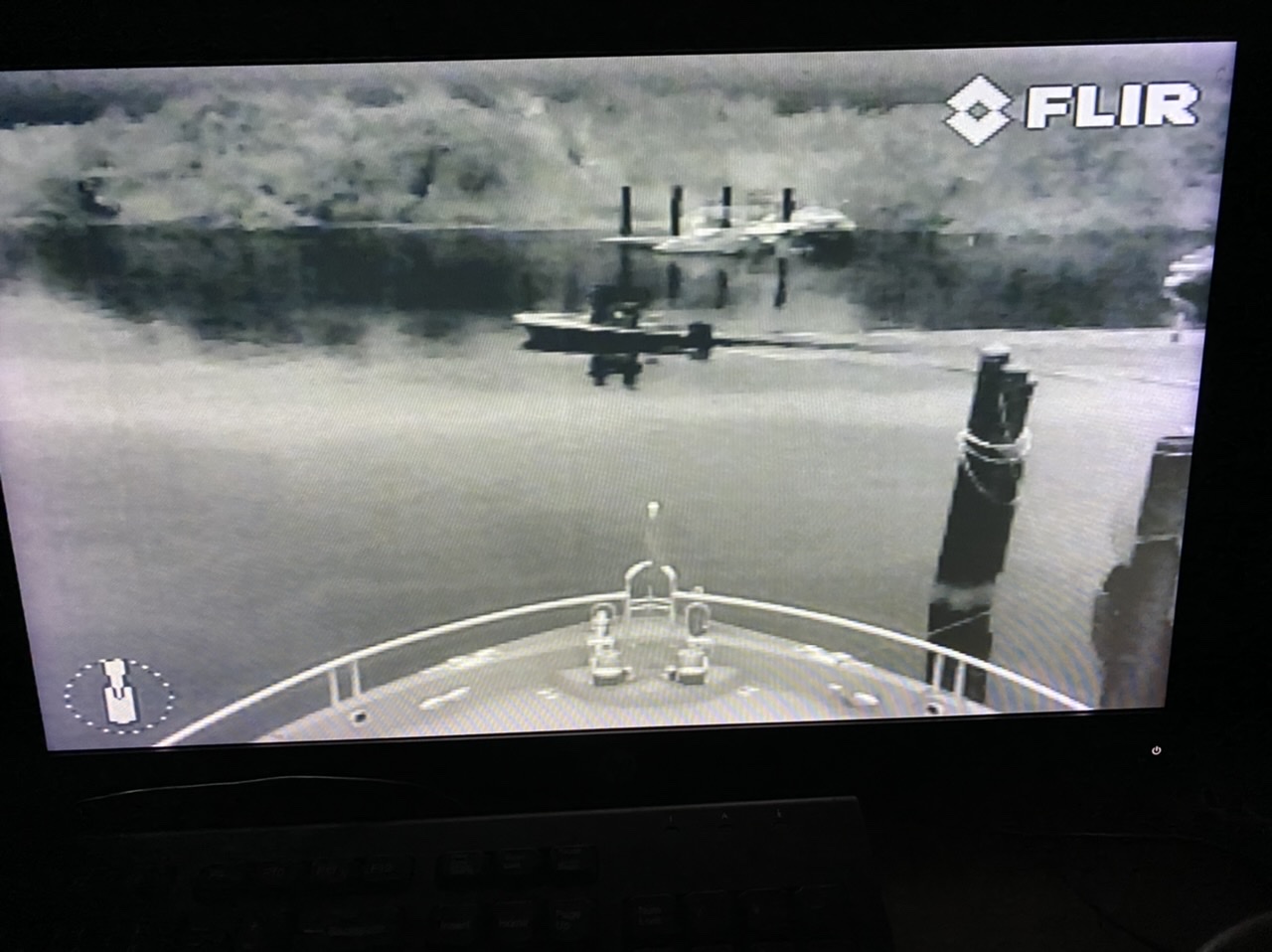

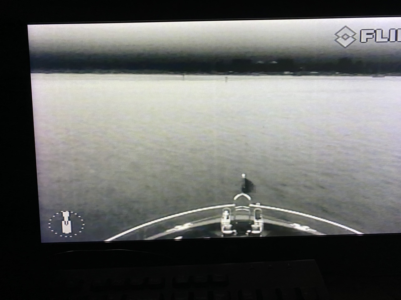

  18. Pascal
    8,932
    Last two.
    first one was taken 1/4 mile (measured by radar) from the two day markers
    second one shows a marker at close range and a sunken mast less sailboat tied to it
    note that under certain conditions, hot humid muggy nights, visibility and contrast can be less than half of what it was tonight

  19. bernd1972
    bernd1972 Senior Member
    Mar 1, 2011
    310
    Flensburg, Germany
    Ok, that´s pretty useable. I´m inpressed!
  20. Pascal
    8,932
    Again that s on a full size monitor. Put the image on a smaller screen and these day markers at 1/4 mile will not be visible
