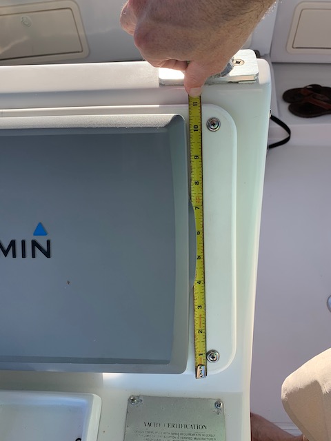

    We're replacing our chartplotter and will need to install that on a piece of king starboard to then add into the dash on our 2001 Tournament 340. Does anyone here have experience working with the King Starboard? We're pretty handy, so I am not too worried about that part, but any tips/tricks would be helpful.
    The key question is does anyone with a Luhrs in the early 2000's know which color white of the King Starboard best matches the gel coat? I am struggling with the patience of ordering samples then starting the project.
    Appreciate any insights the group has!
