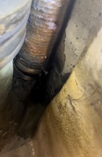

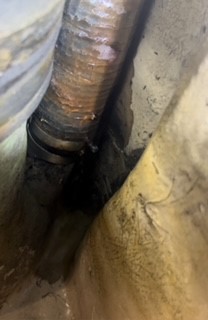

    I recently had the 2.5" exhaust hose for a generator fail and leak water into the boat. Fortunately bilge indicators and alarm worked as they should, and I was able to shut down generator and shove a plug in at the transom. I will replace the hose. I am also going to replace the 10" hoses for the mains. Does anybody have feedback on how often they should be changed? The hoses are dated 2006 and look ok but I'll replace anyway. I am also looking on feedback of blue silicon vs standard hose with wire. I'm probably going to use the standard hose unless there's a compelling reason to use the silicon hose.
    BTW I had somehow overlooked inspecting the generator hose prior to failure as it was completely tucked away behind the main exhaust hose. I needed mirrors to take a look... so just a word of warning to others that may have same situation (surveyor missed it as well)

    No Chafing. Looks like wire failed from within and the hose failed. The boat is a Viking 53c with the Viking mufflers and they are in great condition. I should have caught the Generator hose before it split open. I'm just going to play it safe and replace all the exhaust hoses.
