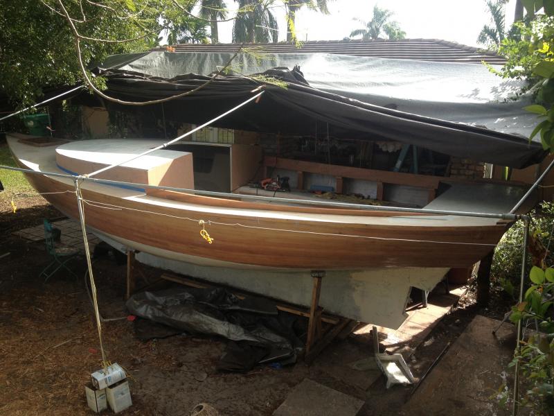

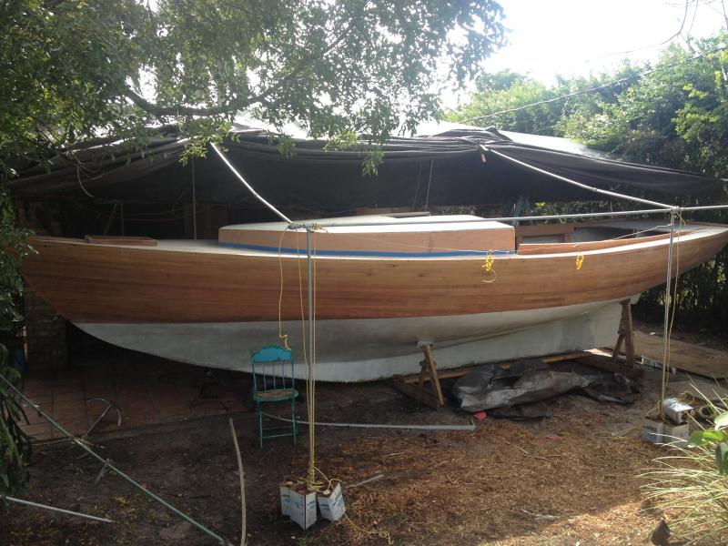

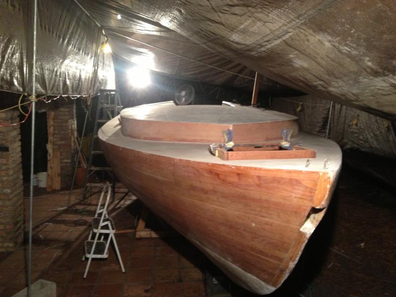

    Hey Guys,
    Thanks for the input.
    Here is the situation. Beautiful old yawl. +/- 37' LOA. Planking 1 1/4 Mahogany strip planking. Frames 1 1/8 x 1 1/8 oak on 12" centers, rivited.
    Several of the frames are broken at the turn of the bilge due to a hard grounding years ago.
    The boat was built in the 60's. No sheathing in the beginning. The deck and interior are out. The hull is sandblasted outside and stripped very clean inside.
    I intend to sheathe the outside. Although the mahogany looks great now I plan on a paint finish mostly due to some previous filling from the grounding.
    On the inside I anticipated laminating in replacement frames but I am wondering about;
    removing the frames and floors, laminating a skin of reinforced epoxy, laminating in some critical frames esp midships, replacing the floor timbers and making much of the interior structural.
    I've got time and will find the budget but need to get a sound plan without spending my epoxy money on engineers and NA's!
    Regards,

    Ok, the broken frames can be sistered with plywood on both sides to regain their strength, it's very commonly done and works well. Use a good quality marine grade plywood, 1/2 or 3/4" both sides and offset the joints.
    If sounds like the hull is fine as it is and you aren't looking to add a tremendous amount of strength, correct? If so, then a single layer of biax weave should be sufficient overlapping at the chines/keel, 1208 and 1708 are very commonly available and often used in this situation but not the best choice in my opinion.
    You will still have a certain amount of movement in the structure and the glass will move differently which often causes cracking at the glass seams. With a single layer of glass there's really no way around the problem, butt joints or overlaps which get sanded fair and made into butt joints anyway are stress concentration areas, the fibers carying the load ending at the butt joint cannot transfer the stress to the next course of cloth..
    Since you are using epoxy I would suggest using two layers of a 1200 or 1700 instead and offsetting the strips of glass. The difference is in the chopped strand mat (the 08 part of the number) or lack of. Chopped mat was added to fiberglass weave mainly for polyester resins but isn't required or often desirable for epoxy. You can apply two layers of 1700 and have the same wet out thickness and weight as a single layer of 1708 but double the strength of the laminate and stresses will travel interlayer across seams much better. Using a weave with different axis orientation (0/90* vs. +/-45*) for one of the layers is another good idea and would further distribute stress. It is an additional step but can be done at the same time to save some effort once you get used to it, having a thinner viscosity resin also helps but not so thin as drainout becomes a problem.
    You really shouldn't "replace" framing with an additional inside skin, sistering them will be sufficient. A problem many sheathed boats have is water being trapped on the inside causing rot. Since you have access now, I would at the minimum thoroughly epoxy coat everything, at least two coats and fill any and all voids/cracks in grain to seal it up completely. Glassing the inside of a framed boat is a ROYAL pain and a lot of work. You have to round over all the framing, pull fillets in all the inside corners first and keel/chine/floor frame bolts can be a nightmare. If you don't (and most don't) glass inside at least seal it as best you can and install a dripless shaft seal if it has one. Keeping the bilge dry is essential to long life once it's sheathed unlike when it wasn't.

    So here is the situation. With the deck off and the interior off, we had the boat sand blasted by a firm that had done several boats for me a decade ago. Really neat and perfect finish. Inside the work was done by hand and she is clean.
    The last two years the boat has been out of the weather in a good fabric shed.
    My partner has already carefully removed and replaced for of the broken frames with bench jig laminated replacements. The proposition I am exploring is not a crude lamination of glass over deteriorated frames but rather whether there was merit to laminating reinforcement to the inside of the planking while removing and replacing as many as 50% of the frames?
    Would creating a "core" of mahogany with structural skins contribute enough strength to eliminate many of the 50% of frames that were needlessly removed. Would it not be possible to eliminate replacing a few more since the inside skin would allow secondary bonding so that the new furniture could be structural?
    By the way, nice looking boat Pascal. I enjoy that same that classic look.

    A short answer to your question is no or at least it's not advised unless you have a big budget and are madly in love with the boat.
    Turning a plank on frame into a cold molded boat could be done but not without completely re-engineering the entire structure. Certainly scantlings could be derrived to make use of the existing core but the inside skin has to be uninterrupted which would mean complete removal of all framing and a female jig would have to be built to hold her shape while that was done. Extra laminations would have to be done on both sides of the core to accomodate high load locations like chainplates, keel and possibly mast step, things that the framing is taking care of now. Of course anything CAN be done, but the expenditure will be tremendous!

    Just to make sure we are all on the same page, the boat is not plank on frame. It's strip planked. Edge glued and edge fastened. There are no signs of any movement anywhere in the tightly beveled seams (glued) but a serious grounding broke many frames. At this stage what I have at present (not including the engine, rig, sails, electronics, stove, liferaft etc etc) is a very fair, empty hull with no interior or deck framing and a large amount of broken frames resulting from a mishap.
    There is enough integrity in the strip planking that once the outside is laminated I would have no concerns about removing a large area of framing, laminating a structural skin, installing some new frames or structural furniture and moving on to another area.
    There seems to be a consensus against that...

    Stop you might be in need of a Naval Architect and Engineer
    Bill106 sounds like you have much practical experience and skill in these repair improvements! Thinking maybe Wirless should hire you... after hearing his plan@?!
    Thanks for the comment.
    Why use the three layers of thinner material is that for the type of situation supposed here... covering a boat for barrier and abrasion resistance is that it is much easier to handle thin layers during layup as once can paint on the resin and then drape the cloth and smooth out while getting pretty much full wetting and then paint another coat of epoxy over... and so on... and it will be easier simpler and quicker for an amateur... you can even go away let set up between layer too. Even 5 oz material takes more skill and the results will be more critical to achieve for an amateur. Whatever will result in high resin to fiber ratios and will not be optimal for structure but the thinner plies will come closer.
    Yes, my experience is aircraft and automotive racing as to composites.
    Sorry for the typos in my I sometimes cannot see them the first time or two through... and I get in a rush and get sloppy.
    Anyway, Wireless... OMG.
    You are talking a major reengineering of the boat. Really using it as a rough form for something structurally totally different. Your project is more challenging than Pascal's new build... and more risky.
    Boats... are or were primarily engineered by rules of thumb... or scantlings, and still are to some extent. Why, is with practical experience it become known what worked and what did not. Lloyds, ABS etc still have this aspect to their rules. But now-a-days the computer and modeling rule. Why, is until the computer calculating the true situation was not possible... so it was done by experience... which by collective experience became rules or thumb or scantlings. The intuitive process was more important than the quantitative understanding because you could not calculate the true stresses and stains. Now-a-days its still the same but the tools are available to quantitatively check your guesses. What you are accomplishing is much on the level of Pascal's new build using the original boat as a starting place or form. Practically you have very much less control of the situation than he does.
    But likely you will (or have to) over engineer the thing, and if your practical technique is good as to accomplishing the work you will succeed. But I wonder if you will save or spend more money than Pascal... ? But the result will be heavier than the original boat if you are not careful.
    So you will have to consider the Naval Architecture aspects of ballast ratios, buoyancy... etc. You may end up with an unhappy performing result if you are not careful.
    As to sandwich construction with a wood core... it is NOT SANDWICH construction... structurally. Unless you make the skins impossibly heavy the core material you suppose is actually structurally just a thick ply of a less dense and strong material with different properties than the skins. I don't think your planking is "end grain Mahogany". So for any practical application of what you suggest, the mahogany planking, will take the bending, hogging loads and the skins will take the shear loads... at very best, and very heavy, maybe the skins and "core planking" will share the loads. This is opposite the concept of sandwich construction so there are no guides to give you any quantitative guide as to how much, how thick or anything. Usually in sandwich construction the core takes the shear loads and the skin all others. I am quite sure this will not happen in your case. So don't think it works anything like sandwich structures... it don't in this case. It will be more like a very thick single skin structure so plan accordingly or perhaps like a laminated fiberglass bow arm (bows and arrows ref). It will be a single skin material with hard surfaces and a bond lines between. The idea of removing frames needs to be thought about... and someone with engineering and naval architecture background consulted.
    I think your critical aspect in this will be the bond line between your wood planking and the skins and what is feasible there... as the shear forces from bending and hogging will transfer shapely across that bond line which is not very thick... and quite brittle... and you are likely to experience de-laminations between the fiberglass skins and planking if you aren't careful. It is not be a "bond" failure really, I am not talking about failure of the bond line itself, but that the wood is much weaker (about 7-10 times) than the epoxy bond line so the wood fibers at the juncture will shear... if you do microscopic examination you will see its the wood that failed not the bond to it. By using an epoxy adhesive with more elongation and a thicker bond line will help prevent this or prestressing the skins. Pascal having the thick core to spread the shear stress though more gradually will have much less likelihood of de-lamination at the bond line... FYI.
    I would just fix the boat as it was designed and add a layer of the epoxy glass for barrier and abrasion resistance as you first indicated.

    ACtually Wireless plank on frame and strip planked are the same animal. Breaking or cracking frames is also fairly common be it due to grounding, pounding or overpowering and abuse. Many times the hull skin doesn't appear to be damaged and may in fact not be, the stiffer frames won't bend and give and if the impacts great enough they will break. It's very common in the sportfish world to doube and even triple frame thickness in engine rooms and bottoms to add stiffness but even then they still break or crack. Many started sistering frames with plywood for added strength and it works very well especially on knuckles (chines) where they usually are two seperate frames bolted together.
    Back to your project, removing a frame or two here and there usually won't change her shape noticably, removing a series of them will more than likely though. You will end up glassing the inside in sections which will bring another dimension to overlaps and glass seams which will further add weight to correct. It can be done but unless you are willing to invest much more than it will ever be worth restoring her I'd advise against doing it. Fix the broken frames, epoxy coat inside and glass the outside and enjoy.
