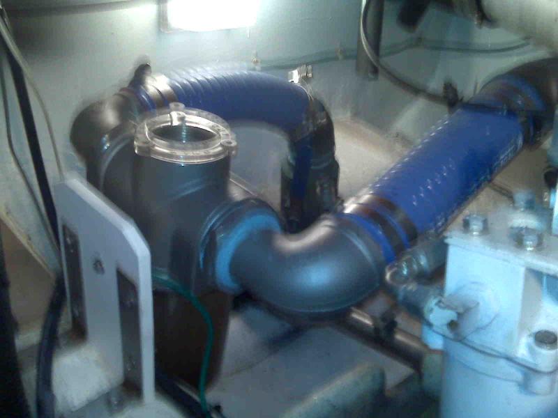

    i added some internal sea strainers for the mains.
    After finding a mussel farm in my gear coolers.
    My Post only came with the external wedge type sea strainers.
    Now it has both.
    I am ready to replace a few through hulls which are through bolted to the outside of the hull. That should be fun.....

    Lou, I had closed up a few holes where old tranducers came through, this winter I will eliminate 2 or 3 thru hulls for the toilets and the lecsan?. I went with fresh water vacuflush heads. I think I am gonna follow you and also do the same thing with the engine strainers. Let me know what sizes you used. Is there enough room around there?

    here is a pic of the sea strainers i put in the late 80's 46 Post.
    they are mounted on a fabricated bracket on the stringer inboard of the engines near the battery box.
    The strainers are 3inch Groco stainless steel.
    I can flush/winterize the engine by shutting the valve and screwing a standard PVC pipe into the clean out.
    see pic

    Looks good. I am adding internal strainers as well and have eliminated the outside wedges. I too have to deal with old bolts and relate holes in the process.
    Your seacock in that shot - is it a NPS/NPT flange or just a straight NPT/NPT without flange? If the latter, is it mounted real close or even flush to the collar nut of the thru-hull?
    Thanks

    it is the flange type, you cant really see it in the pic.
    sorry for the pic quality

    I'm not sure why you would eliminate the wedges for a flanged thru-hull. The flanges serve two purposes, direct the water flow while underway and provide a rough screen to keep stuff from being sucked in. This is not so critical for ancillary devices like head intakes but for mains,gennies and a/c you want all the flow you can get.

    I agree and it's always easier to replace with what you already have

    Thanks RT46 - looks like a good setup.
    Thanks to others for good advice on wedges - not a problem on my sailboat! But I now understand the benefits for the Post.
