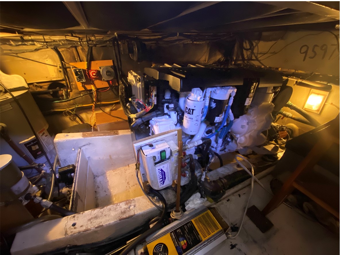

    Our 43 has about 3" thick acoustic matting on the undeside of the hatches (look above the engines), and thick acoustic batting on boards mounted to stand-off the hull sides. (can see around the board holding bettery cutoffs). No idea when/who put it in, I had presumed it was factory?
    -greg

    cant believe how much room is in Greg Page's 43 engine room with those cats!

    The CATs are at least a foot shorter then the DD's. The old engine mount holes are filled with resin. I like being able to sit on the stringers ahead of the engines to access the engines and the systems on the outboard side. I think the top clearance to the hatches is larger as well. The transmissions are in essentially the same place.

    really nice job, C9's?
