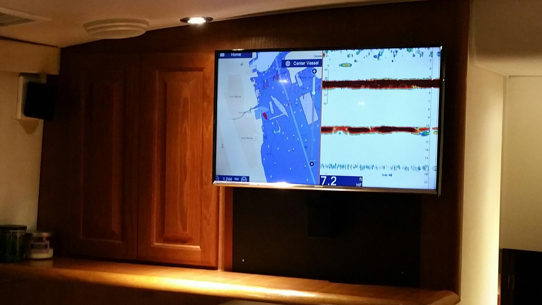

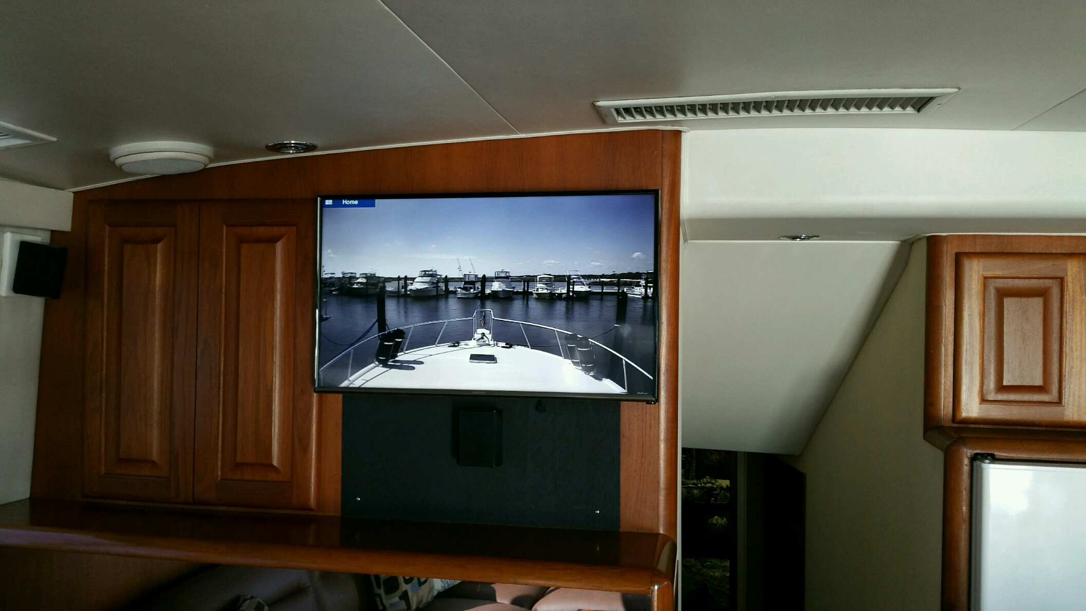

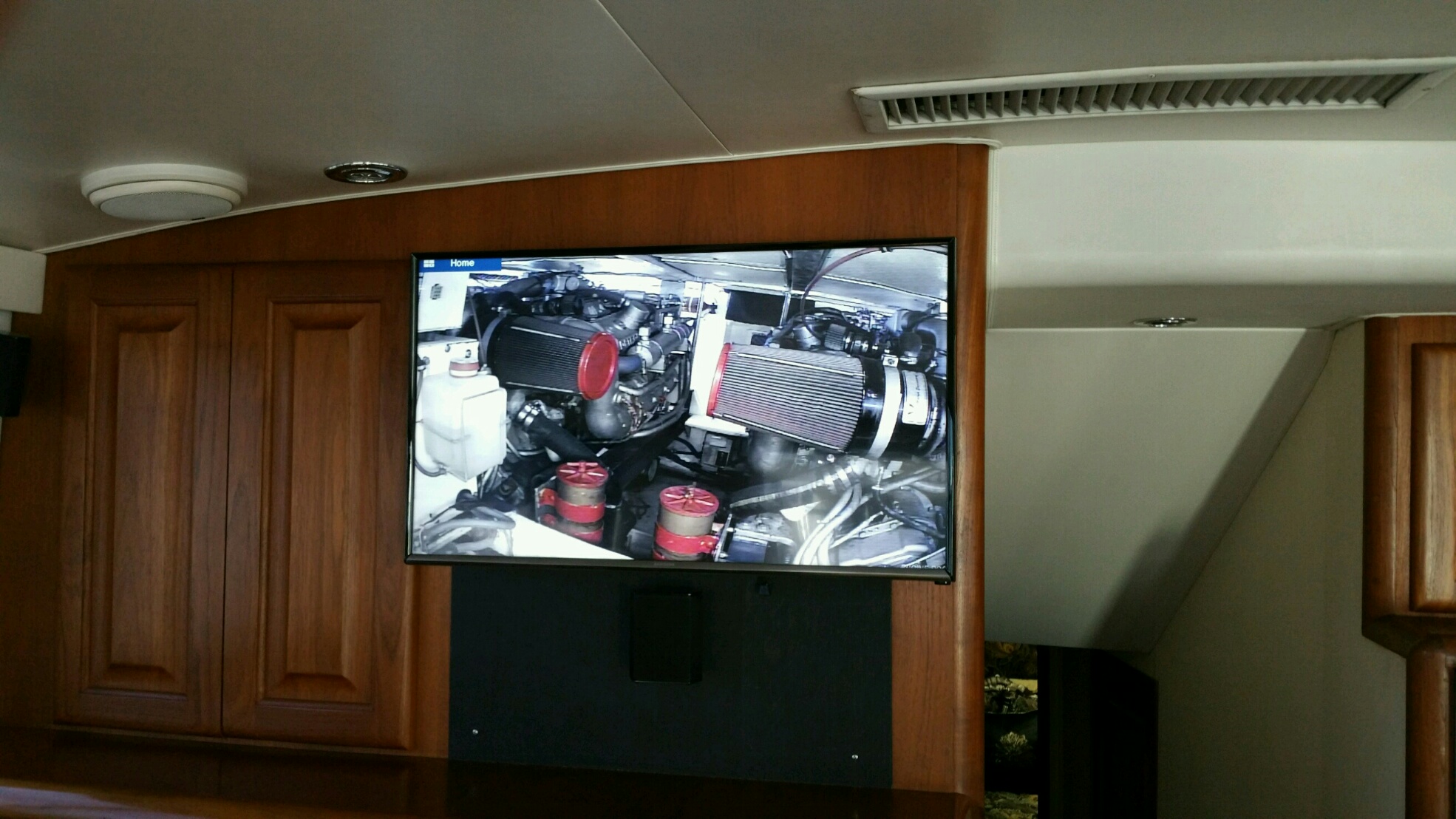

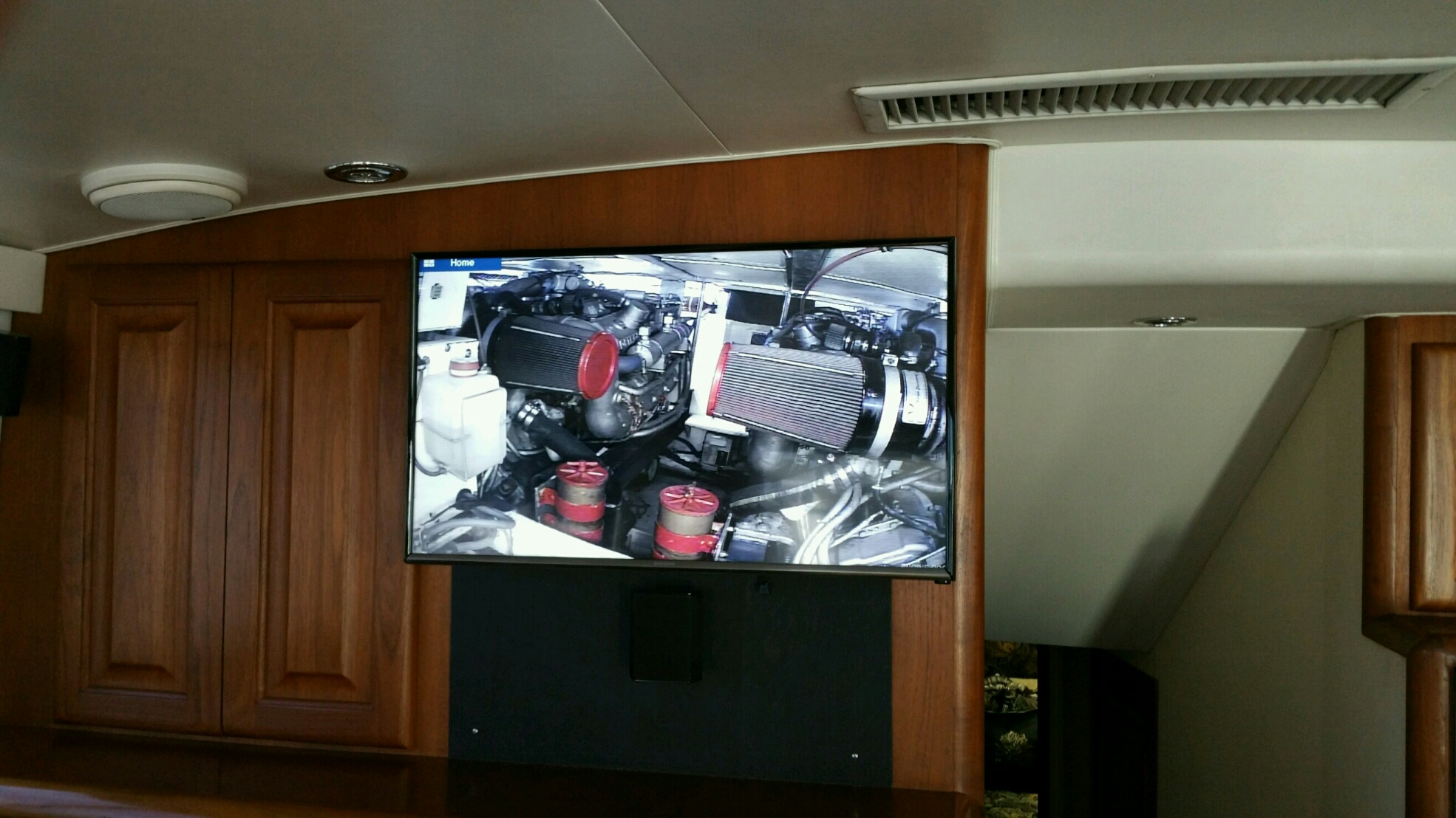

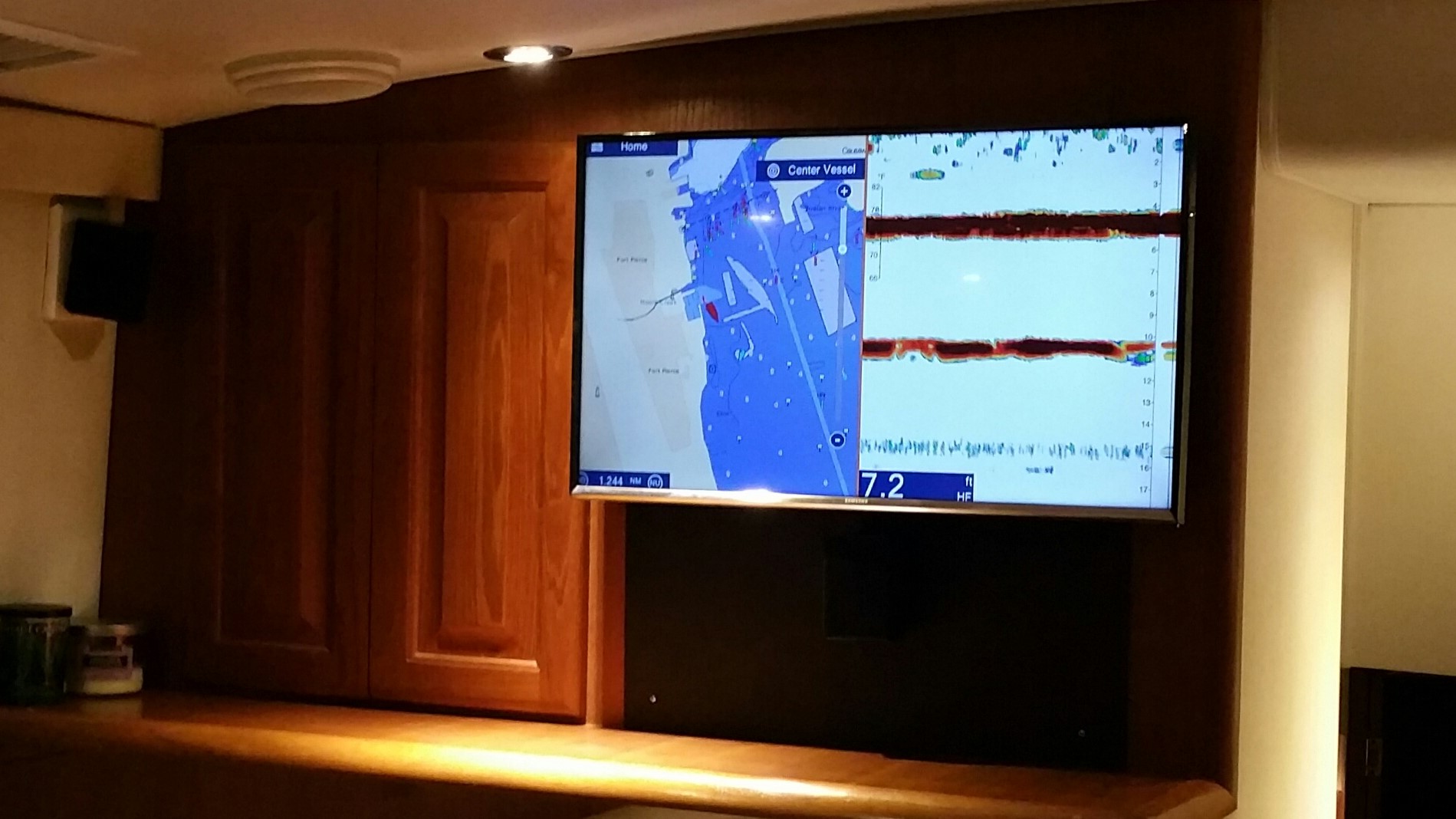

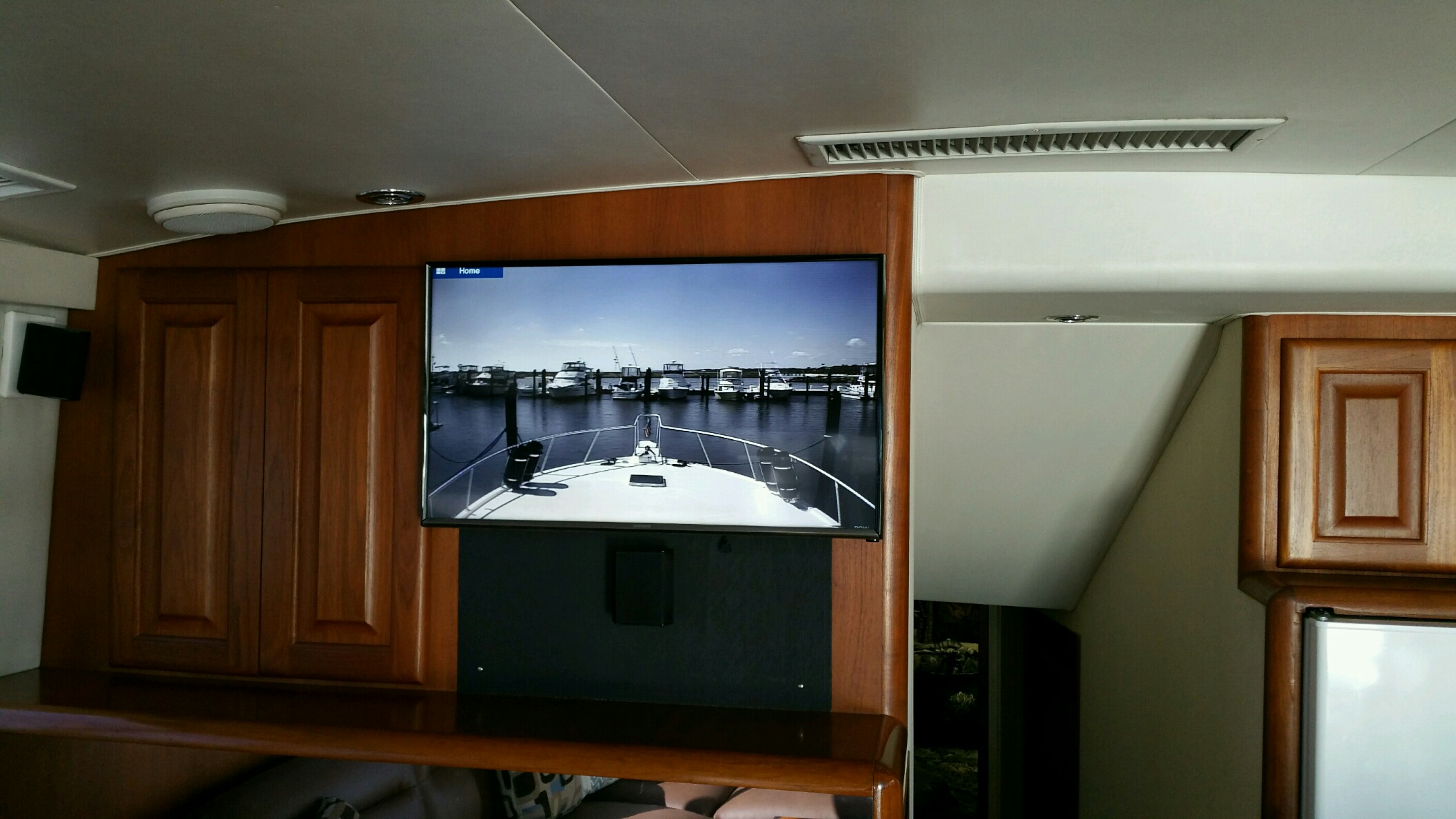

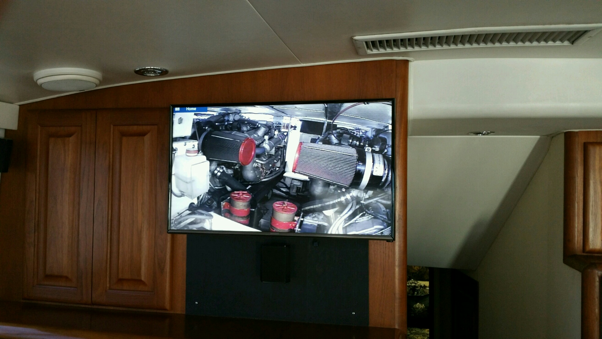

    The 2 Furuno machines installed on my boat have 2 each bnc connections for camera's. I put one in the engine room, one in the cockpit and one on the bow. It's not necessary to leave the lights on in the engine room but it makes for a better picture if you do. I also ran a HDMI cable down to the salon TV to display my main machine there.
    This is the camera I got off Amazon. https://www.amazon.com/EWETON-Secur...coding=UTF8&psc=1&refRID=5MYSAZTPHX3F3WZHFCVS
    Here are a couple of pics

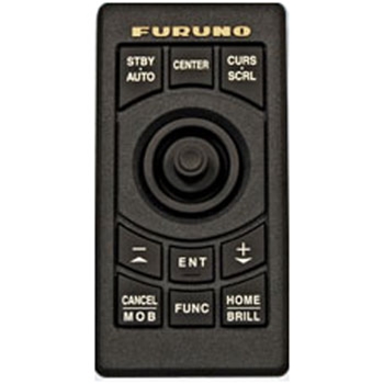

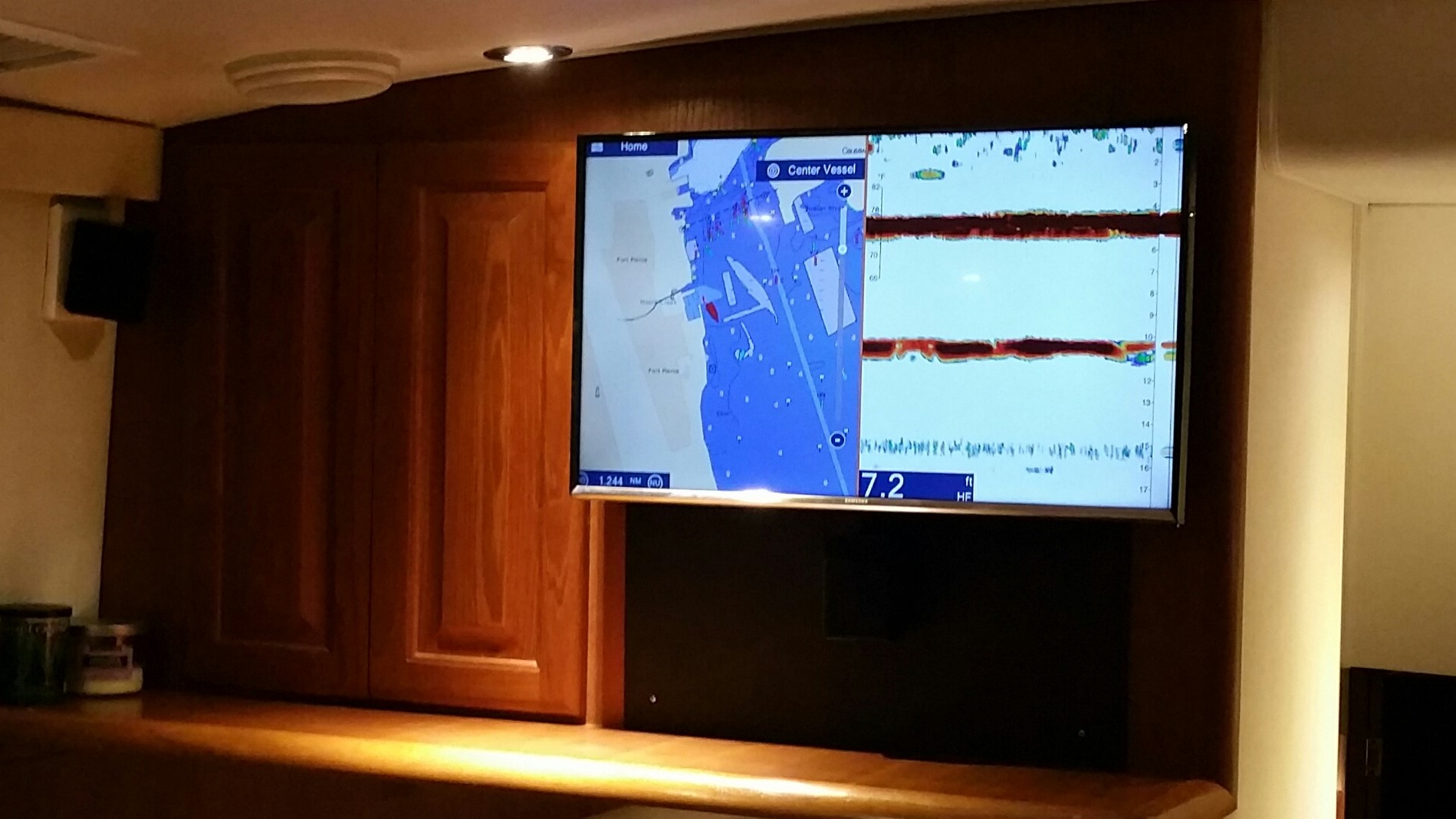

    I can also use my main machine from the salon via a wired remote.

    How is your TV used as a wired remote? What kind of system you using?
    I like it!
  11. ReelPlumber
    ReelPlumber Member
    Jun 14, 2015
    56
    Fort Pierce
    The TV is only used as a display. Furuno has wired remote panel that I put next to the salon door so that when I'm in the cockpit fishing I can use the machine as if I were at the helm. As long as I can see the TV I can use the remote to scroll around on the screen and do anything with the machine.
