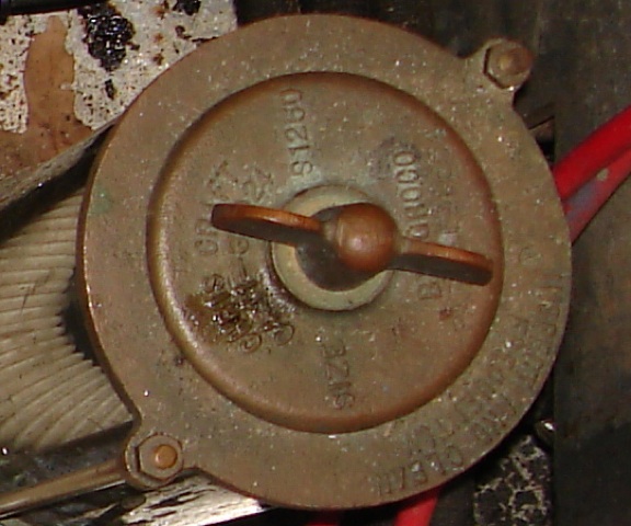

    Here is what I know so far:
    - you are right about the manufacturer - Groco
    - these parts went out of production in or around 1986
    - the rubber replacements for the existing shut off valves went out of
    production in or about 1993
    - the part number is SVS1000 & SVS1250 (1000 = 1" and 1250 = 1.25")
    - strainer and glass is the same as the current models.
    The bad news is that the replacement seals/rubber plugs are no longer available which means replacement of the unit. These units were only used on CC and Grand Banks boats. I have a picture somewhere...
  5. crewzin
    crewzin New Member
    Jul 13, 2007
    15
    Arkansas
    See picture...

  7. q240z
    q240z New Member
    Oct 24, 2007
    285
    zsedr
    crewzin, you've got exactly what I've got. The only parts I need are the sight glasses and gaskets for them. As alloyed2sea said, you can make the gaskets easily enough. Are you rubber valve inserts (or whatever you call them) broken? Mine were in fine shape, and this was a very unloved boat.
