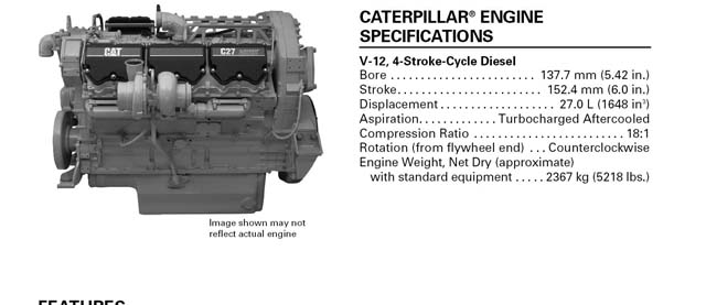

    You might want to open the hood and have another look at your C 27's.
    They are a V12 Engine which according to the CAT Spec sheets has exactly the same physical bore and stroke as the C 32.
    I posted a C 27 Spec sheet with that link above, click on it and have a look.
  10. K1W1
    7,427
    Here is the top of the Spec Sheet.
  11. Capt J
    14,530
    According to this, it sounds like it was designed to be used in equipment because it's a V12, yet makes the same HP as the C18. So I would assume being a V12, that it makes more torque then the C18. Also a severely detuned C32 would have more longevity.
  12. travler
    travler Senior Member
    Oct 14, 2008
    276
    roche harbor wa
    the diffrence is in the stroke the bore is the same and the fuel arangement is a little diffrent and i did go out to the job site to check it out you are right ,thanks for the correction i was missleading my self
  13. K1W1
    7,427
    Your welcome.
    You will probably find that the increased fuel rate is accompanied by a greater boost pressure and a different Camshaft Profile on the C 32 v the C 27.
