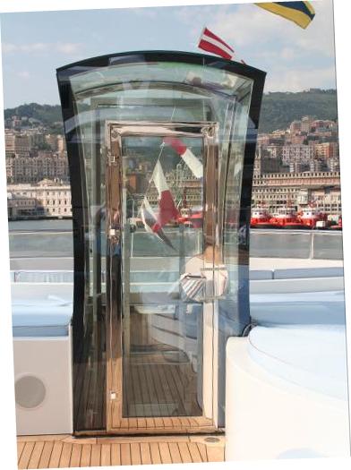

    How did Benetti make the elevator on Latinou work? I assumed hydraulics since there is no pulley system above it.
  15. K1W1
    7,453
    It's a Benneti, it might not work and have been in that position for the pic.

    Yes, it must be hydraulics, (unless it was really just for the photo). Hydraulics have all the moving parts below the lift in the pit. I believe hydraulics are considered safer, but would welcome a second opinion on that.

    This lift is a platform lifting device. meaning not a real elevator.
    Meaning dead mans control max speed 0,18 m/sec.
    For the lifts on yachts we say use 0,6 m/sec
