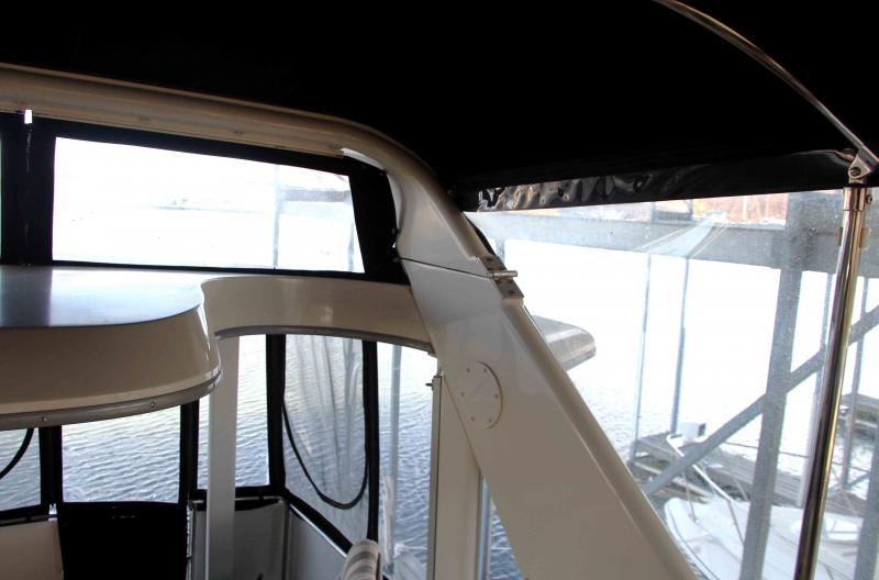

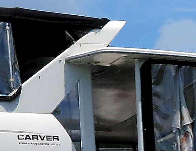

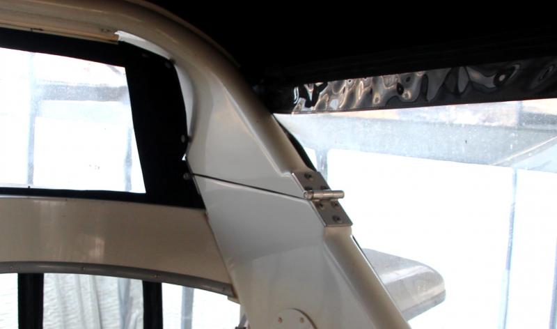

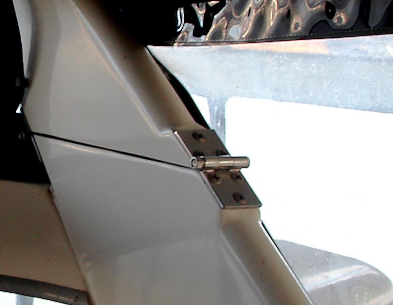

    i read your post as a question on whether its doable on your 406.
    i dont think the others who responded actually have carvers but i thought i would chime in. i actually have a carver 405 the same, just model year different which was actually hinged when built by carver, this was the only boat i found while we were researching and viewing that had one. we saw at least 10. i am owner #2 and the original owner had ordered it this way from them. its hinge pads are molded into the arch and a wider flatter section was incorporated into the arch in this area. i know its feasible to do, whether its a do it yourself thing or not?.. where i am docked its a must, do to varying water on the lake and the bridge i must get under. i dont have have to lay it down all the time but when needed its great. i had already been trying to figure if this could be done on this model before finding this boat which seem to say here i am when we found it was already hinged. i can say its heavier than i thought it might be but its sure a nice thing to have, very thick aluminum but will reduce the overall height to 12.5-13ft when folded over . i also cut my anchor light and modified it to where i can rotate it to the side to reduce height there, i have to do this to get in my covered slip the arch and bimini up are fine for that. best wishes

    G36,
    I have the 2000 406 which is currently not fitted with a hinged arch. I will have to (at some point) remove my arch to tend to some "dissimilar metal bubbling" that exists. I'm very interested in where and how your hinged arch is set up. Would you happen to have any pictures of where the hinge point is and what the mounts look like? I am very curious. Seems like the having them installed when I remove the arch for sand and paint would make sense.
    Thanks in advance,
    Joe

    i can take some better pics and post them so you can see where the cut and hinges are on the arch this is all
    i had right now.
  12. g36
    g36 Member
    Aug 7, 2013
    70
    chattanooga
    oops found a few more
