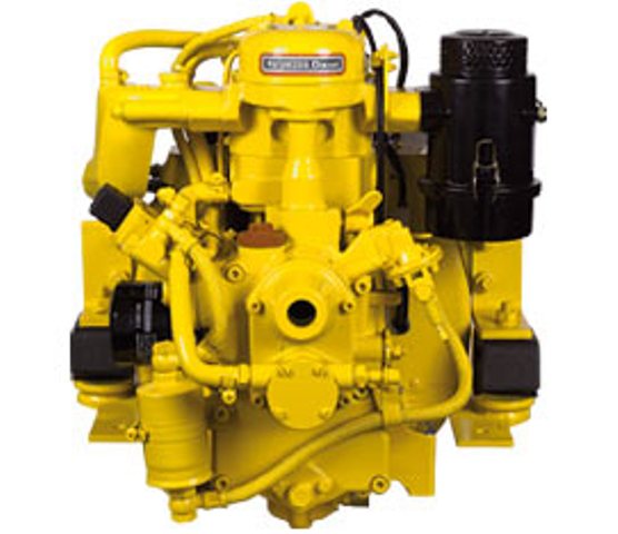

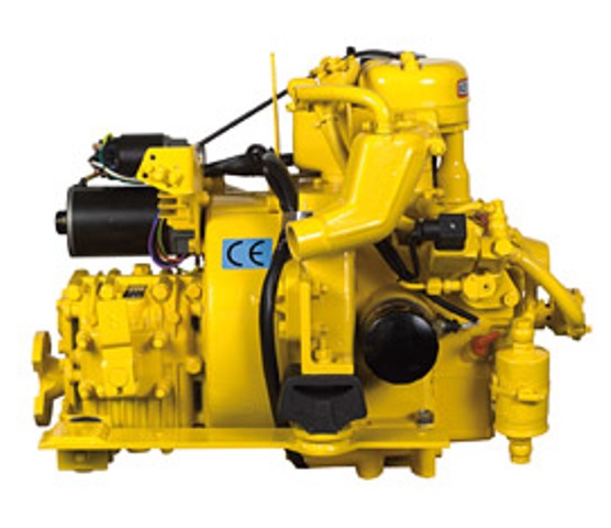

    If you really like the smell, bang and clang, this would be your engine. 140 lbs total system weight, enough power for the Duffy and it will outlast your grandchildren. Farymann single cylinder marine diesel engine. You can leave the electric starter out, it can be handcranked. A nasty little piston shaker but runs on 2 Gal of diesel 8 hours long at cruise RPM. And for hardcore diesel fans, there is an air cooled version with even more noise :D.

    True, but they're very anemic. They only do 5 knots-5.5 knots depending on the length and proper cruising speed is 4.5 knots otherwise your range is really cut in 1/3. I'd take a diesel, with good soundproofing and a good muffler anyday but everyone is different.
