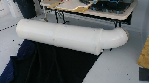

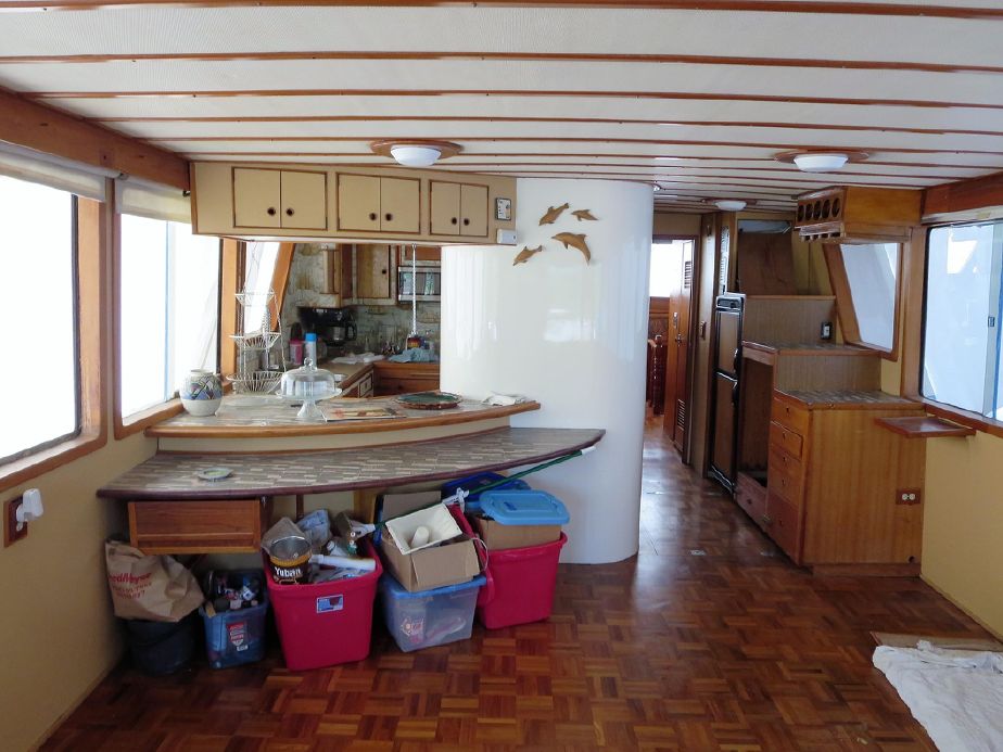

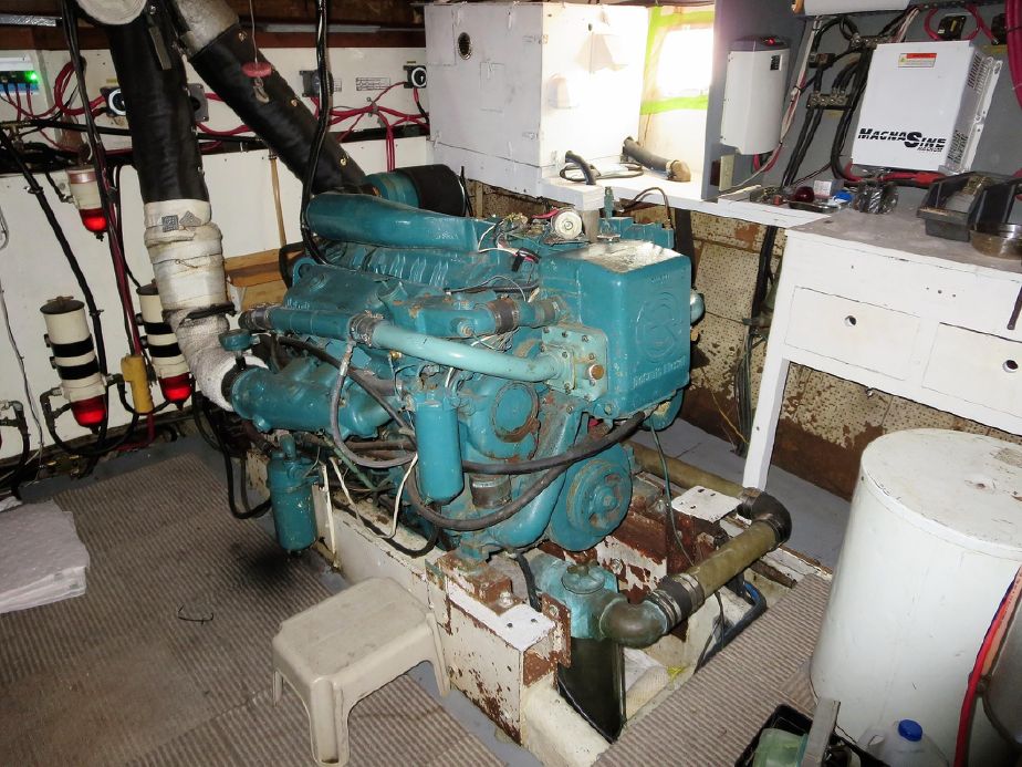

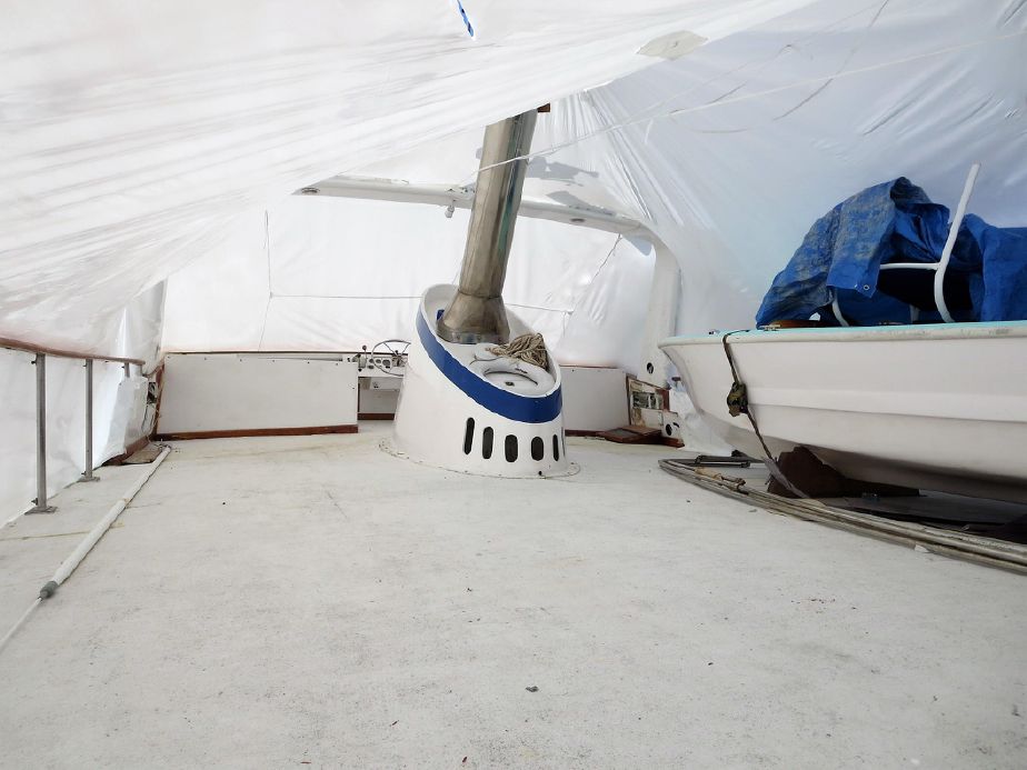

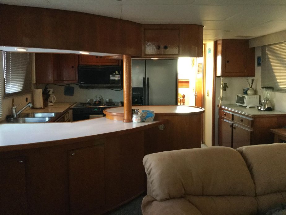

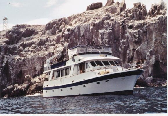

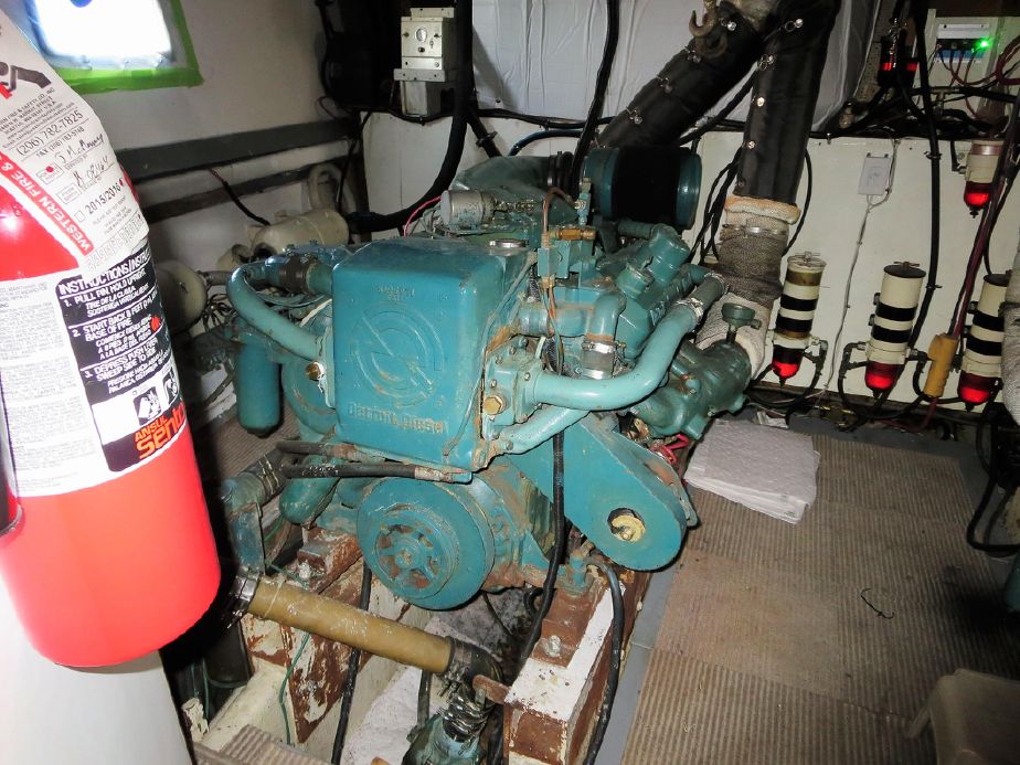

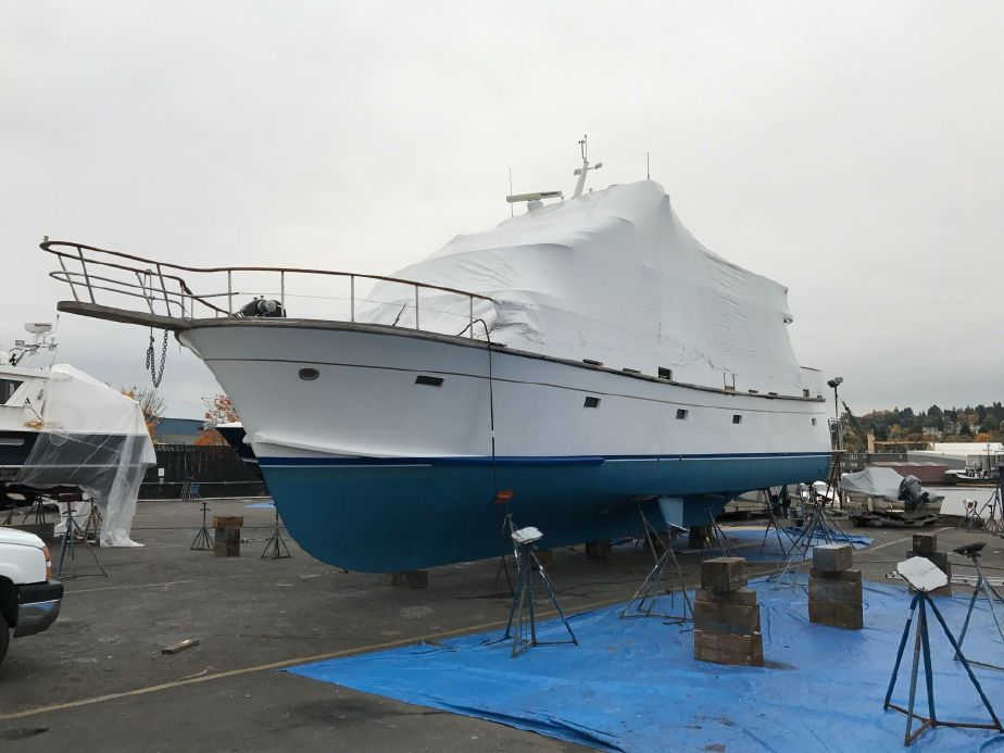

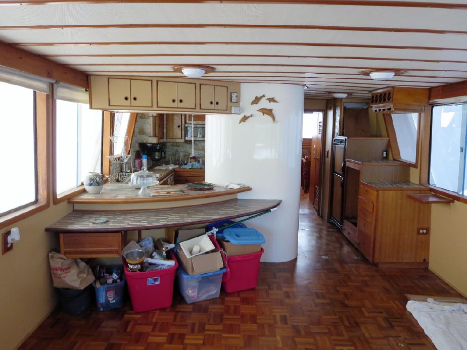

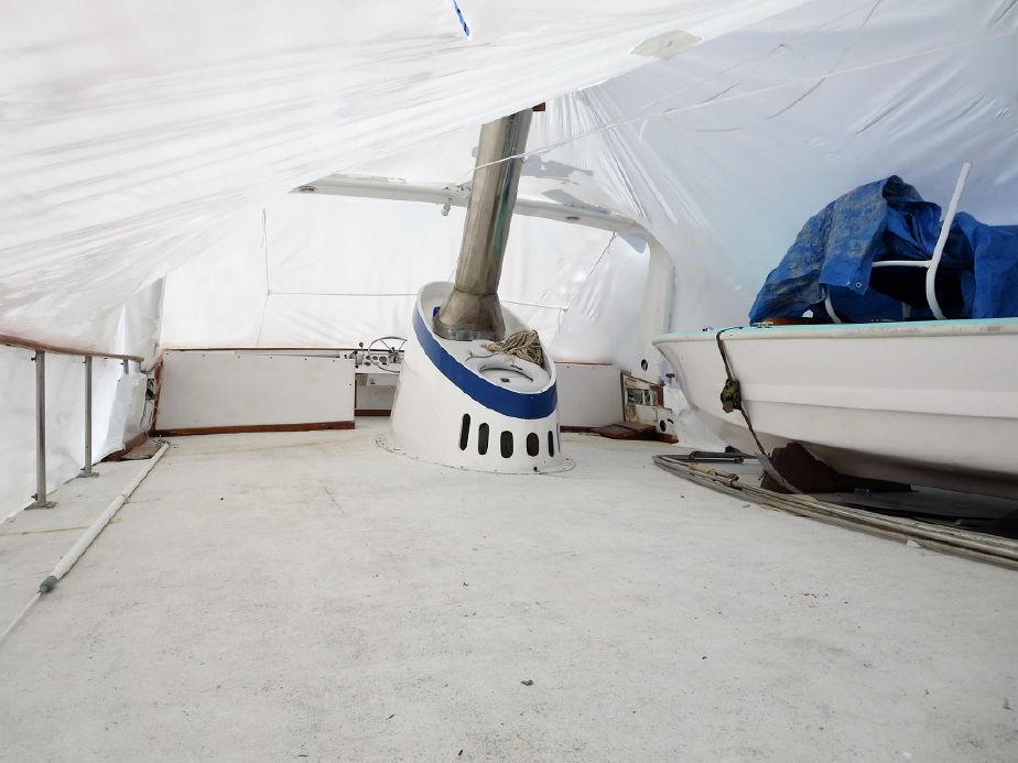

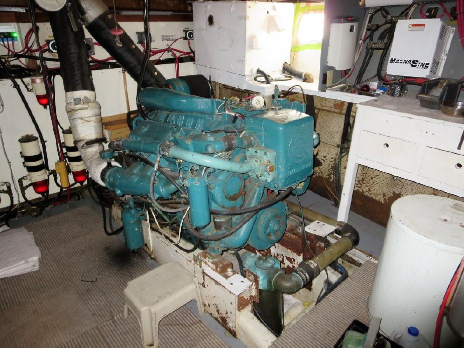

    Thanks for all the input ,hopefully I can get these pics up the boat with the dry stack and a sistership with side exhaust ,if I remove the fiberglass structure that encloses dry stack, I will have to install joist to tie the ceiling together and sheet the bridge deck ,probably be a good idea to put a support pole in, I should be able to sell the dry stack parts? The fiber glass smoke stack on the bridge looks to be really heavy,, the exhaust would probably go out the side at the waterline behind the stabilizers 658BF796-02A4-4010-AB64-70F9E9D24CE9.jpeg 6AEF3645-190F-40A5-8694-978FFA76B446.jpeg EC8F8B4C-9B61-4336-A11C-3F20687F134F.jpeg EB81BD20-64F8-4870-BD27-F4B6C5C21EBF.jpeg A46066C1-7C4C-49BD-88C5-66588E21933E.jpeg

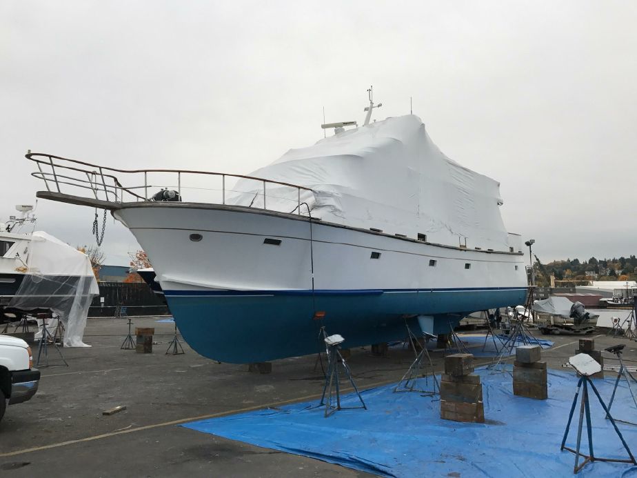

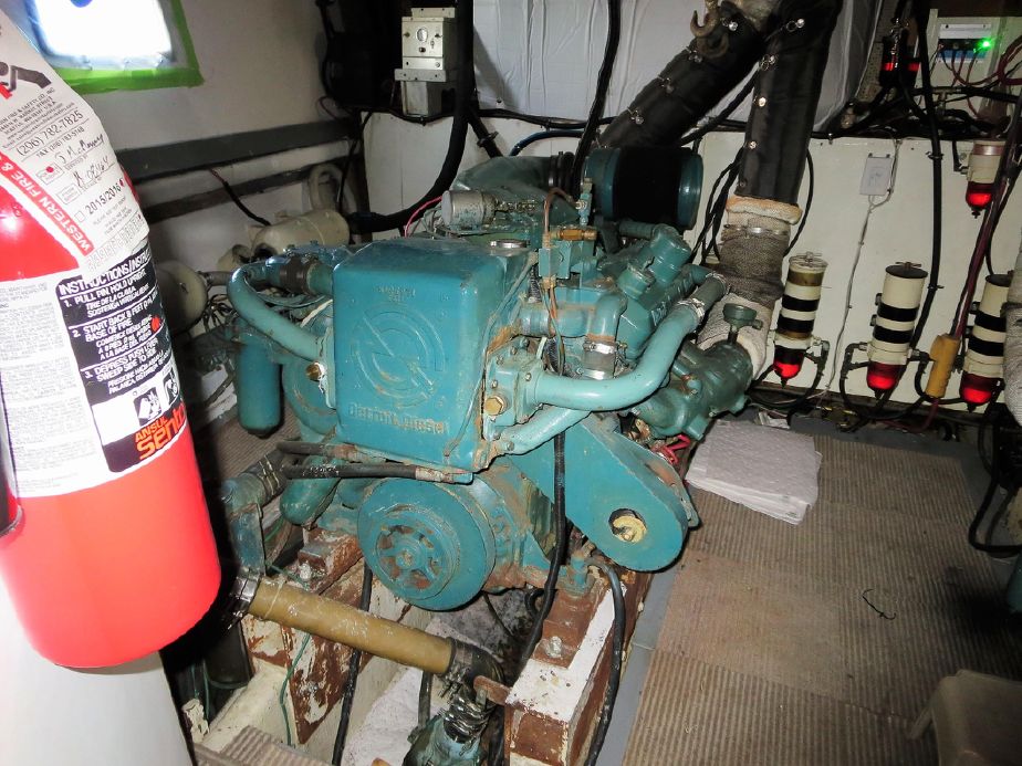

    This is the sister ship with side exhaust , I assume it’s at the waterline or the same level as it would if it was ran to the transom?it looks like there is a big muffler running on the starboard side below the port hole in the engine room, looks like the side exhaust is at the waterline in the picture C2A9ED36-C075-47A7-AFA2-C73C759CF7E9.jpeg B41B6EA9-C04C-4286-BE17-A507BBEAE59C.jpeg 321BFB2C-2F09-45D5-9800-C0E54B92F8AC.jpeg C2A9ED36-C075-47A7-AFA2-C73C759CF7E9.jpeg B33B9303-1802-408F-91E4-5891467002F8.jpeg B33B9303-1802-408F-91E4-5891467002F8.jpeg

    Room for an underwater muffler or thru hull?
    No muffler needed if the exhaust is going underwater.
    Big space saver. 8' glass tube from the hull bottom, maybe a 2' idle hole out the side at the water line.
    Single dump can from each engine.
    Mufflers seem to eat up some serious room in the second set of pics.
