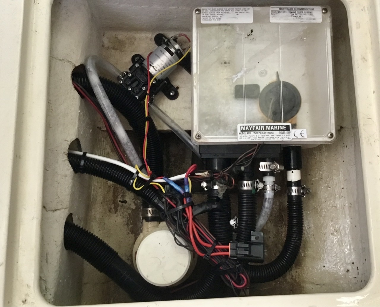

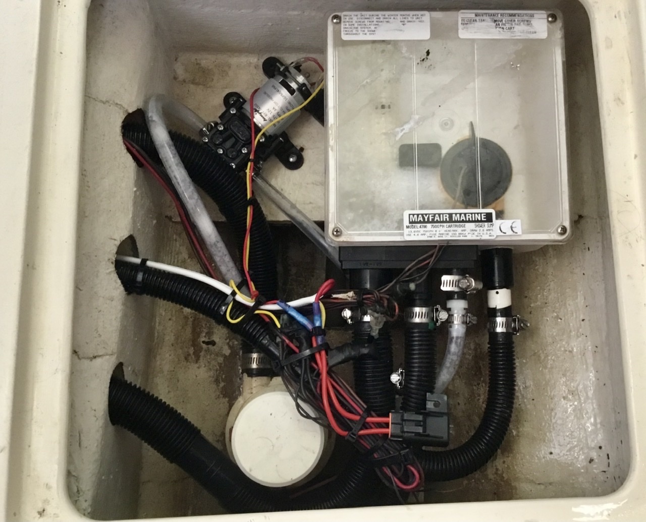

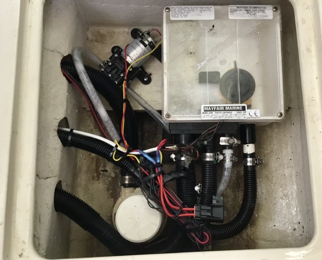

    Installed this little 12 volt sump-pump a few years ago: (upper left corner)
    It sucks from the bottom of a forward bilge and discharges the water into the shower box where it gets pumped overboard by an another 12 volt pump.
    Works good and sturdy: Left it on overnight by mistake, it ran dry for 8+ hours and kept working forever after. :cool:
    rocdiver and bayoubud like this.

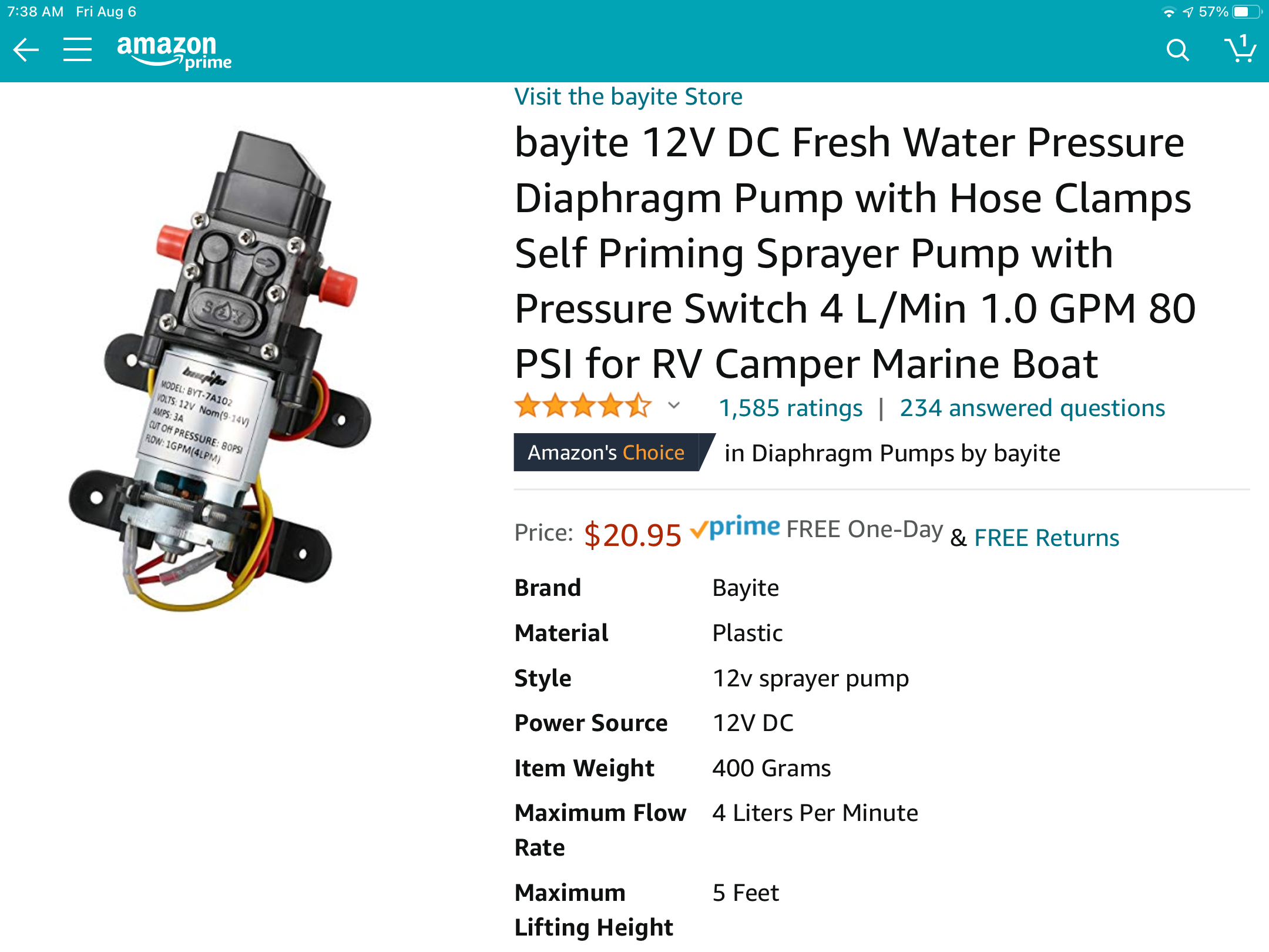

    Can't see the brand/model from your photo, do you mind telling us?
    And do you possibly know if there is also a 24V version?

    Looks like this one only comes as a 12 volt pump.

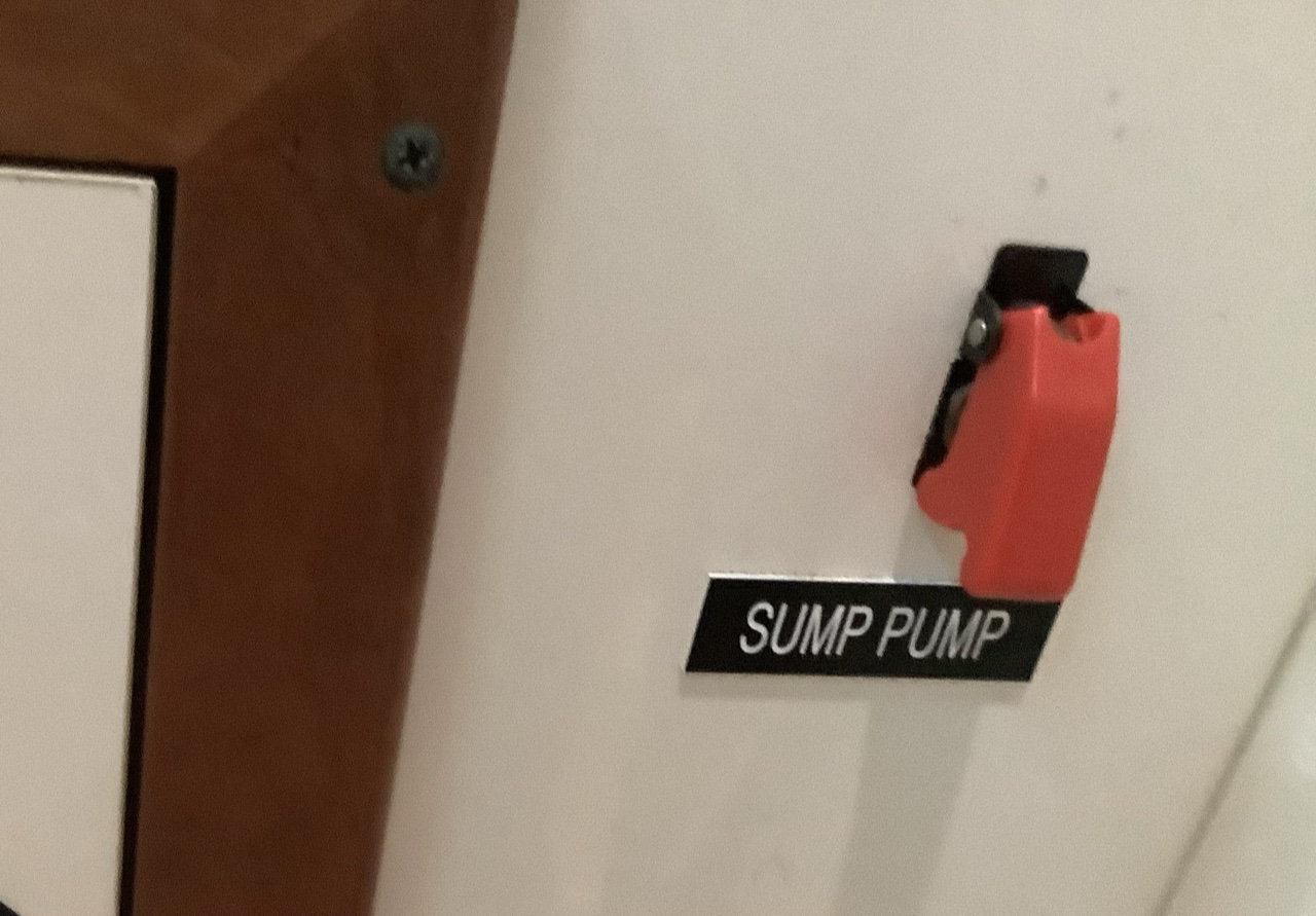

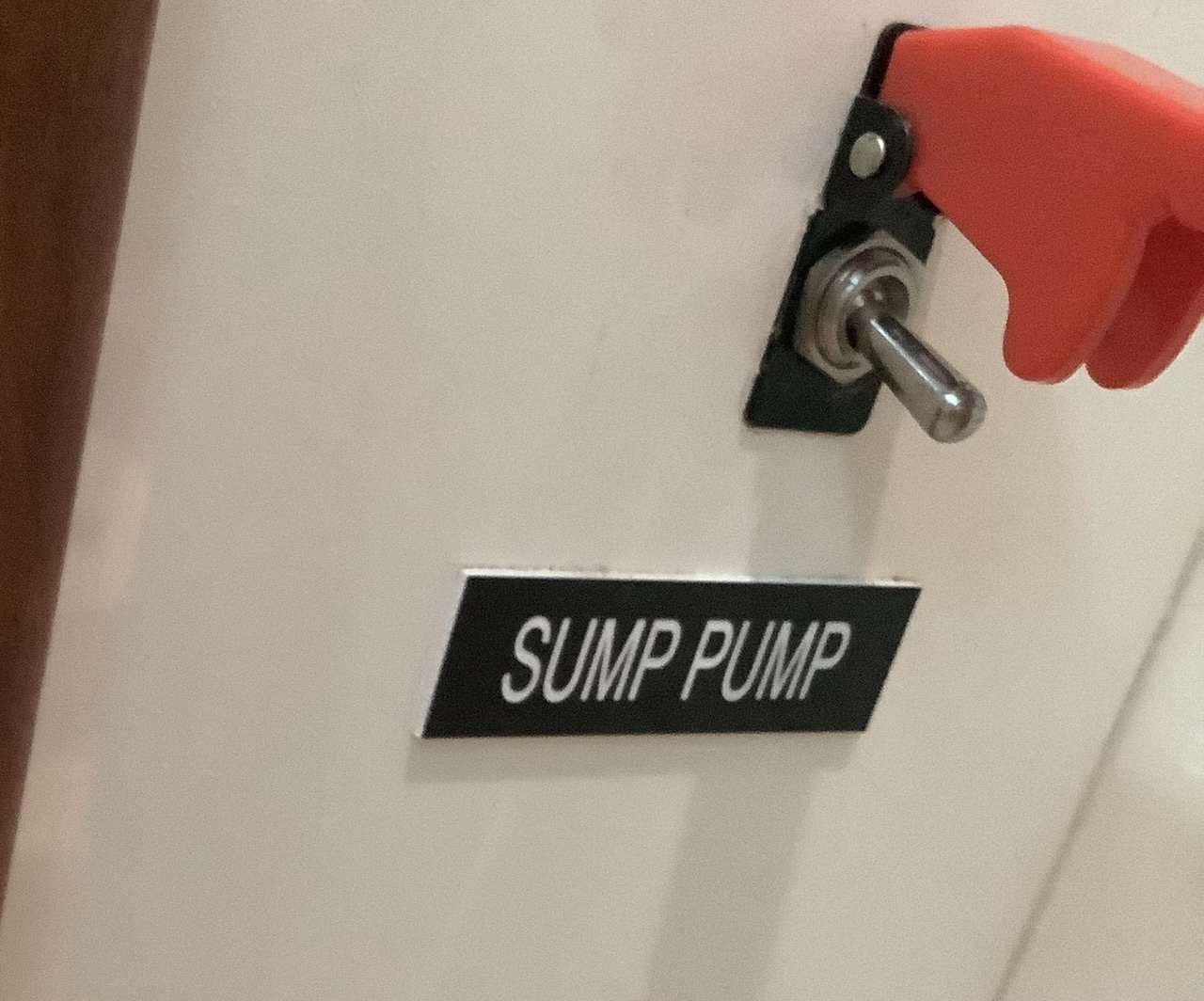

    Yeah, pretty impressed with this little pump, it keeps on going like the energizer bunny, but it does not like to get wet: During the head/tank/plumbing surgery a few months ago the tech mistakenly turned a forward bilge pump to OFF instead of AUTO, or pulled a breaker, fuse or something the little pump got wet and died.
    Strictly on a manual and guarded switch on a head bulkhead:
    2044565A-9655-448E-B73A-56D20D0AE27C.jpeg 31A85FFB-A309-4929-894F-533138AE142D.jpeg

    So your little set up is strictly manual on-off with no float switch ?

    For the Sump Pump yes, but of course the 3 primary bilge pumps are on Auto at all times.
    I am however on the run pretty much every day and if we had rain, I flip the switch and empty the bilge.
    I have considered hooking up a float switch to the Sump Pump, but due to the V-shape of the bilge, I can’t get a float far enough down to be any useful.
    In the meantime, I am Mr. Auto Switch. :cool:
