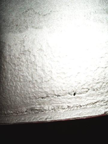

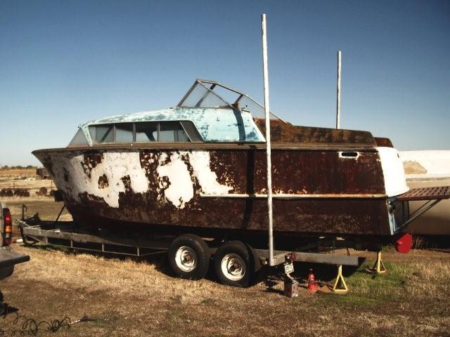

    I recently began restoring a 1958 Roamer 25 Express Cruiser, I chose to sandblast so I could be as thorough as possible and what I discovered was some rust cancer spots and a couple pinholes. My question is; the fabricator wants to plate on the exterior with 1/8 steel plate on top of the freshly sandblasted rust cancer / pinholes. I am concerned about just plating over the freshly sandblasted rust areas, does anyone know if this is the proper way to double plate or should I try to primer the trapped metal/rust before plating and if not how much time do I have in these areas before rust over powers the weld and new plate?

    Hi no way you must cut away all bad plates weld in to gather in the proper way.

    WOW! are you sure you want to undertake a project like this?????maybe the hull isn't as bad as it looks in the pics, but WOW!!!...i agree...cutting out the bad is the only way to go...otherwise, rust will just fester under the patch like cancer...Tim

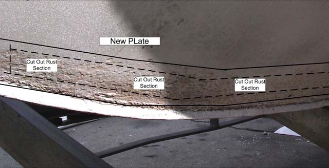

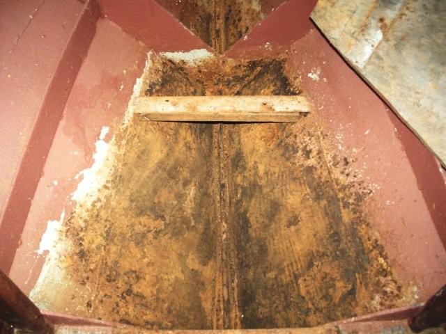

    The rust you see in the last picture is all surface rust, the person I bought It from prepped the boat for primer then parked it outside for 6 months so all that rust just dusted off with no pits. The main damage towards the front keel of the boat where so bilge water had sat inside for a few months. What I was thinking of doing was grinding out as much rust as I can or possibly cutting the infection out then welding a piece of 1/8 steel on top of good metal. Below I have attached a picture he solid black line is the new plate and the dotted line is where I am thinking I need to cut or grind down. Please let me know if this is the best way I don’t want to be to destructive unless necessary.

    Hi Yes that the way you should do it we veld first on the inside then on the outside.Im gong to put in some pic from my job so you can see more my english is not so good.

    It is rusted inside also but only seems to be near the front keel for about 24" long and 8" high on both sides, i'm thinking that the steel could have of been weakin by the loading and unloading from trailer over the years or pulling ashore to sand and rock "maybe now i know why they named the boat Ice Breaker". Their is a pinhole below the gastank and two bad welds that left holes around the prop, everything alse looks pretty good. i taped the areas for the welder and put my first coat of primer on yesterday. ~Billy

    I guess your idea of "looks pretty good" and mine are different. IMO you have a good bit of metal to remove and replace. You'd be wise to invest in a plasma cutter and a magnetic straight edge to run it against. Not that big of a job really if you have the right tools. Weld from the inside first, grind the weld in the seam even from the outside and then weld the outside. If you have the right equipment you're looking at 4 days work to do it right. Remember, no corners where plate meets patch, always use as large of a radius as you can fit.

    Crazy? No, there's a bunch of ways to take care of this, but the right way is to cut away the rotten metal back to good (from your pictures I'd cut it up to that first seam) and insert a new plate and flush weld it in. That is the proper way of replacing metal. Heck, you could just get a tub of Belzona and trowl it on and fair it. It would most likely last several years with no issues. It wouldn't be right though. At the end of the day, it's your boat. I've fixed this kind of stuff various different ways, as long as the boat isn't in class, there's nobody to object to it. If it were in class, the surveyor would tell you to cut it back and put in a new plate. I have also seen people sand blast the pits, fill them with a Mig welder, grind them flush and paint before the surveyor shows up. It's up to you to decide how you want this project to go.

    Reality as kicked in and it looks like I am going to be cutting some rust out. I’m sure I will be asking for more help Thanks for the info ~Billy
