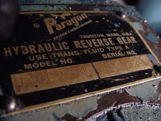

    A much easier method is to look at the serial number or other data stamped on your paragons. If you see something that reads like HJ7C25L, then I think it's a 2.5 left hand rotation tranny you've got. Take a look and see if you can see a similar number.

    Sometimes when you're old (and I guess that includes me) you tend to forget things! If you're running 427 motors, chances are all you have to do is look at your serial number on the exhaust manifold. Both manifolds have "chris craft" plates, but one of them has the actual serial number of your motor/transmission combination. They were sold as a "unit" and not as a motor with a seperate tranny. Therefore, on your motor ID tag, if you see something that reads like this, 427 25L, it will signify the 427 motor, and a transmission of 2.5 to 1 gear reduction, with Left hand rotation. A 427 20 tag would be a 2.0 to 1 gear reduction in the right hand rotation.
