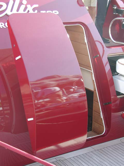

    Here is an off topic question from a green horn, Capt. (or anybody else) What in the H**L is a pantographic gate ?
  14. YachtForums
    20,378
    Pantographic doors open parallel to the surface they cover. They are a hybrid; one part sliding door and one part hinged door. They are a necessity when narrow side decks won't allow a typical 'hinged' door to swing completely open. I've attached the pantographic lazzarette door on Ellix Too as an example...

    Ok, that makes sense. Are there any pictures of the actual mechanism on YF ? Complicated hinge assem from the looks of it.
