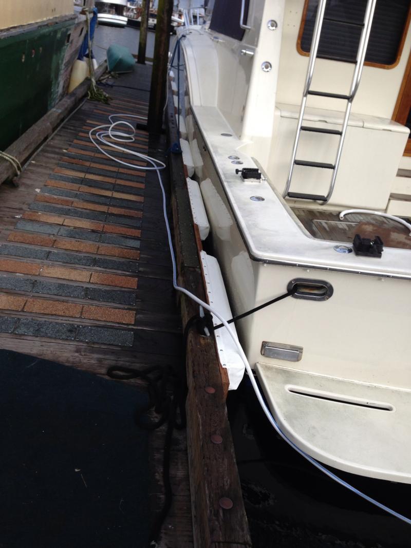

    I'm looking for fenders that I can mount to my dock so I don't have to deal with hanging and stowing fenders every time I go out. Anyone have an suggestions or experience? I've been looking online quite a bit but not finding much. I would prefer an inflatable fender that mounts horizontally. The boat is a 54' Sportfish and moored where heavy weather is pretty common. I'm was thinking to just use traditional fenders and tie them horizontally but I'm afraid they will just want to roll up when the boat rocks. Appreciate any input.

    Several of us at the marina I stay at have regular fenders horizontally mounted. They are attached at the lip of the dock deck and "hang" over. None of us has had a problem with any of the fenders rolling up onto the dock. We are not in a heavy weather site, but have had very bouncey conditions. We are on floating docks. This will be the 14th season that I'm set up that way. The only downside I have found, is that if you slide along the fenders backing in, they can leave a scuff mark because they don't roll like a vertically secured fender.

    I found out the downside to this the hard way. I had fastened fenders horizontally along the dock and made up mooring lines that stayed on the dock when I took the boat out. I hindsight what I had done was ensure that the hull was tied up at exactly the same spot along the dock every time I tied up.
    It's a dock exposed to some heavy weather so theres a fair bit of vertical movement between the hull and the fenders on the dock. In a few weeks, the rubbing of the fenders wore through the finish right down to the primer.
    What I realized after was that when fenders are attached to the boat, they tend to go up and down with the hull and wear on the dock. When they are attached to the dock the hull rubs up and down against the fenders and wears on the hull.

    Thanks CR Cruiser and BEAU. Maybe I need to rethink this before creating a bigger problem than I'm solving. I don't have the option to tie the boat off the dock and the prevailing wind tends to set me into my dock so perhaps best to leave well enough alone.

    I have my slip lined with No-Mar Fenders from a company called Holmes Products at Boat Fenders Holmes Marine Specialties
    I've had them in the slip for two years and they seem to be doing a good job. I have the dock lines adjusted to the boat is centered in the slip and does not touch the fenders. That prevents the rubbing problem that was mentioned above.
    The only maintenance I give them is a hose down and scrubbing every spring. That keeps them nice looking and gets any dust and dirt out of the fabric covering.

    GFC- Thanks! These are exactly what I was looking for. I contacted the company and they said they are guaranteed not to wear on the boat finish even with a side tie like mine.

    Dockmaster, I wouldn't count on that 'guarantee'. When I first put mine on the boat rubbed against them on the port side. It wore the wax off in one season and left a rub mark on the hull.
    Nothing that a good waxing wouldn't fix, but they will rub a bit. In all fairness to the company, I live in an area where there is a lot of dust and I suspect it was the dust in the fabric not the fabric itself, that wore on the wax.
    I now keep the boat centered in the slip with the dock lines so it can't touch either side. I also pressure wash the fenders in the spring to get all the grit, grime, etc., off the fabric.
    BTW, they've been installed now going on the third year and they look like new after the pressure washing.

    Just a quick follow-up; I bought and installed the No-Mar fenders per info from GFC. So far they are great and doing exactly what I wanted.

    When my folks come in I move the boat close to the dock for ease of boarding (as dockmasters pic shows) ... but then they are not in town I move the boat to the center of the slip for two reasons: it makes it hard to board and thus I do not worry about uninvited "guests" when I'm not at the boat, and I never have to worry about fenders rubbing the side of the boat. I cannot imagine any fender which will not eventually rub the boat raw when moved up and down or side to side.

    The width of the slip is not the issue. I can only tie on one side as there is a boat on the other side of me. In other words, I don't hve finger piers down both sides, only one side. So there is no way to run lines to hold me off the dock.
