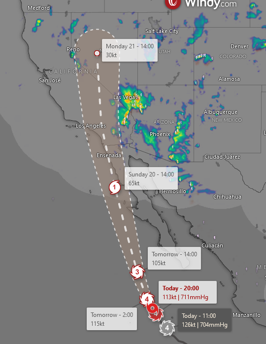

    In reading about that storm coming up to S Cal, Got a great joke about Hilary;
    NWS has declared that any loss of life to be called a suicide. As with any deaths before, around her,,,,
    The NWS, IMO, has done a poor job in predicting this storm also.
    Last SWAG;
    I would advise, get out of the hills and move on your boat.

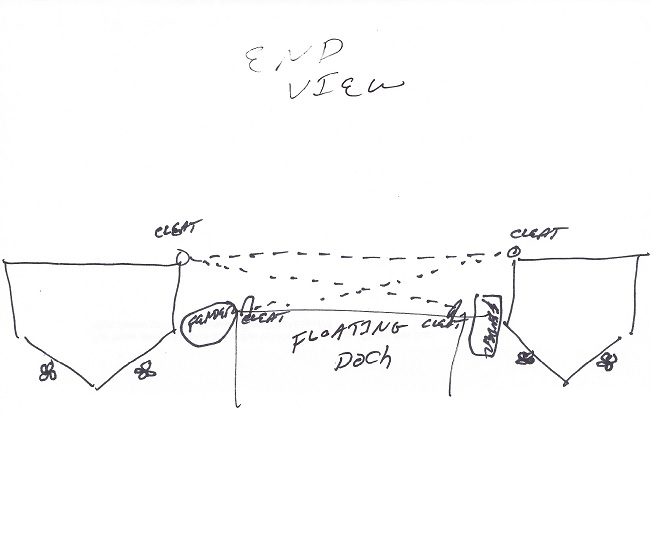

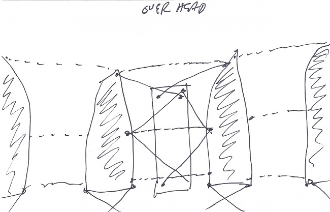

    Tight as in pressed against the fenders?
  11. Capt Ralph
    13,436
    Floating finger dock? Snug and over to the far side and to the boat on the other side of the same floating dock.
    No need for the boats to beat against the floating dock.
    Just in case, NOT to the pile the floating dock rides on.
    Spider web out if you can tie to anything solid and high.
  12. LuvBigBoats
    LuvBigBoats Member
    Feb 9, 2016
    169
    Los Angeles
    It is a floating finger dock but not sure what you mean by "to the boat on the other side of the same floating dock". The boat on the starboard is in a slip, and tying to it does the same thing as tying to the dock. The only other boat is 20' away on another end tie with his starboard facing my port (he's tied up on port). Are you saying I should ask if I could tie up to his starboard side?
  13. Capt J
    14,529
    Yes Snug, but allow for a teeny bit of wiggle.......
  14. Capt Ralph
    13,436
    All boats should be secured to docks or shore, other boats can spider web off of them.
    If lines fail, other lines may still hold the boat in place.
    Scope or angle of lines help also.
    Hard to tie your boat to a floating dock when the lines are vertical.
    More line out, more stretch and less snapping on the cleats also.
    At the last minute is not the time to be receiving advice on tying up a boat.
    When in doubt, open up a Chapman.
