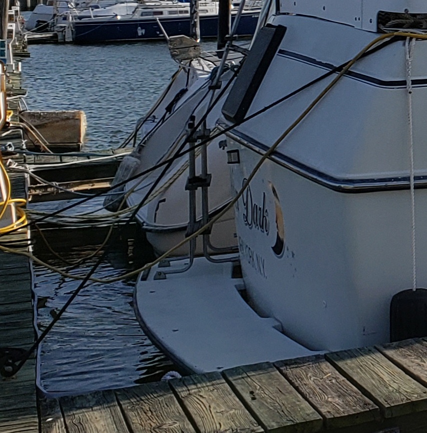

    I am trying to figure out where to place my 11 foot inflatable on my carver 3607.
    I manhandled the dinghy onto the foredeck but that is not going to happen every day.
    The swim platform is not gonna happen because lines conflict.
    Davits on the swim platform make line handling almost impossible
    So I am left with the hard top and some sort of crane. has anyone else done this yet?

    I am not sure but I think that since I am backing into the slip that my crossed stern lines might conflict with the dinghy while in port?
    do you have pictures of this while docked? When my lines go slack at high tide I would think the dinghy caddy would end up conflicting with dock lines.
    maybe I am just not seeing it right.
    I have also see the clips on the swim platform that you just float up to and clip the gunwale tube of the dinghy. That was my first thought but again lines keep me feeling like there is gonna be a problem.

    My google foo is bad. I have not found any images of crossed lines with the dinghy on an aft cabin carver or the likes.
    Does anyone have experience with dinghy caddy and carver 3607 or the likes. I like the system (even though it is grossly over pipes lol.)
    But I think in practice I will tear the thing off my boat the first wind that buffettes my boat in my slip.

    Since you're at a floating dock, and not dealing with tide, why not just install flush-mount cleats on your swim platform. You don't need all that scope. You could also run a fore & aft spring off the existing stbd. cleat and that should keep you off your neighbor. To hold off the dock you could run a spring from the port cleat to your neighbor's cleat (or install another one). I'd check with Carver before trying to put the dink on that roof. I seem to recall a sticker warning against putting weight there.

    Don't know if I would put a cleat on swim platform itself that seems like a really weak point??? But I do like the idea of dinghy caddy or weaver arc setup. Did you really mean cleats on swimplatform or just on the hull at swim platform level???

    "Did you really mean cleats on swim platform or just on the hull at swim platform level???"
    Yes, but of course it depends how secure and substantial your swim platform is.

    My swim platform is much less substantial than that lol.
    Of course I see low cleats on the hull of the picture you posted . As long as I put a substantial backing plate on it I guess I could mount cleats to the transom right at swim platform height.
  17. NYCAP123
    11,205
    That should work. But again look into running fore/aft springs and/or trading cleats with your neighbor. That may be the easiest way to achieve your desired results. I've dealt with a lot of boaters who wanted to keep their sterns clear for boarding or dinks. Thinking outside the box or moving a dock cleat usually gets it done.
