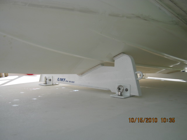

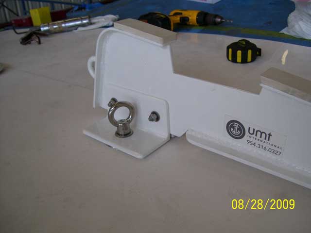

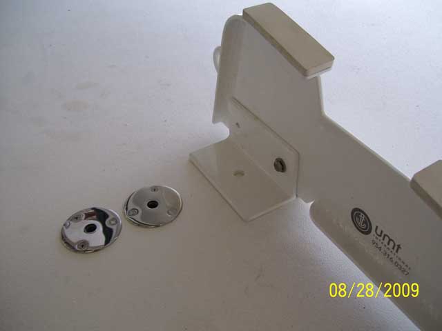

    I have asked for photos of the underside of the parts that go into the deck, but so far only have pics of the topsides. Here they are.
    Dan
  16. K1W1
    7,427
    I would be very keen to know what those screws/bolts were attached to on the other side too.
    I would also not be happy if I were the client and the guy doing the job didn't take enough care to clean the 5200 out of the screw slots very well if at all.
