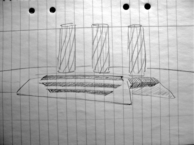

    If you must do a "green" yacht, forget about the thousands of kW and make something like this:

    Isn't anyone going to comment on this fundamental misconception?
  16. YachtForums
    20,610
    Some of the world's greatest technological break-thrus started life as a sketch on a paper napkin, probably over a pint of ale at a local pub. And here we have another example... in just a few pencil strokes, Lars has penned the answer; vertical wind turbines and a bank of solar panels on a multi-hull.
  17. K1W1
    7,427
    Isn't that the truth.
    I have heard the MS DOS started as 12 lines of code on an Airline Napkin during a flight taking two Uni Students to a meeting.
    The rest is now history.

    Solar Sails ?
    Wondering if the idea of Solar Panel Sails has been explored ?
    A lot of great songs started as one line on a napkin, etc. Almost all great art stated as sketches on throw away paper ! Of course it's now delete, delete, delete. Rarely "save as is" !
    Let's make it a motor-sailor with Solar Panel Sails AMG and we got a winner...
    Sorry for the slight thread hi-jack....:)
