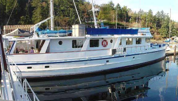

    My '42 Wheeler looks similar to a Hatteras except for the 1/2 cabin top on the foc'sle. My deck on the bow is clear and I have a 7' headroom on the deck below. It was built as a CG patrol boat. It served at D-Day, later in the Pacific, was sold to a fisherman, raised a family on board, and professionally converted to a yacht to a Monk design in the 1970s. From then until I bought it, the boat was used as a charter for PNW inland passage tours and trips to Mexico and points south. I don't think the last owner did too well. The boat was run down, no real maintenance for years, mains and generators needed overhaul, hadn't run in 6 years, etc., when I bought it. I wanted a good sea boat, big enough to haul friends, but small enough I could run it solo, and something to keep my body going in old age.

    In Canada and a sister ship in Normandy
