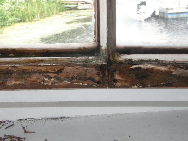

    Mine was doing that too so I took the bottom window trim off to see what was under it.
    These are pictures of what I'm doing about it.
