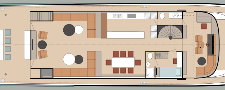

    Hi, on the 80-footer we build, the main deck is an open plan where a day head should take away visibility. Besides, I think it will not give enough privacy in this social area, so we have it down below combined with a laundry forward.

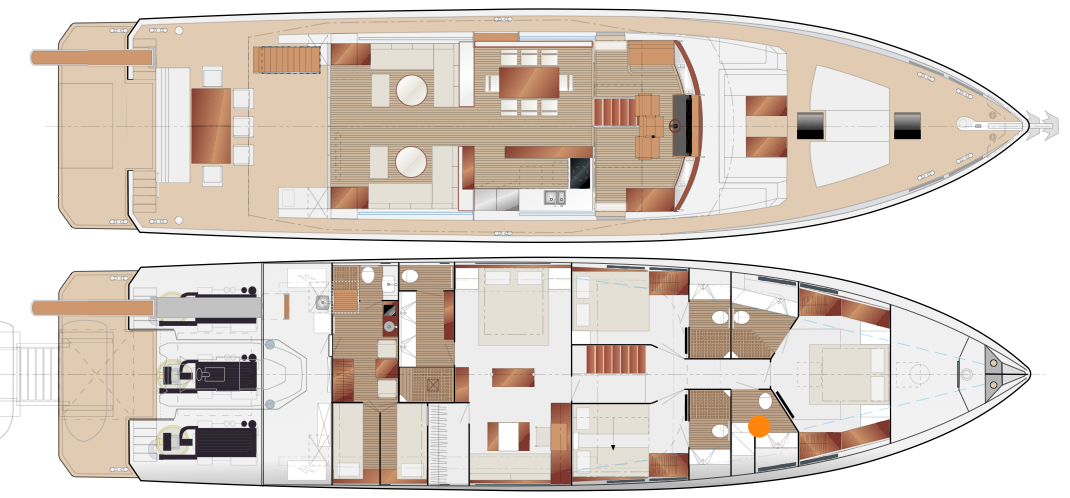

    On a 115 design I have a day head like that, good for the crew but can also be used by guests with access from the semi open wheelhouse...
