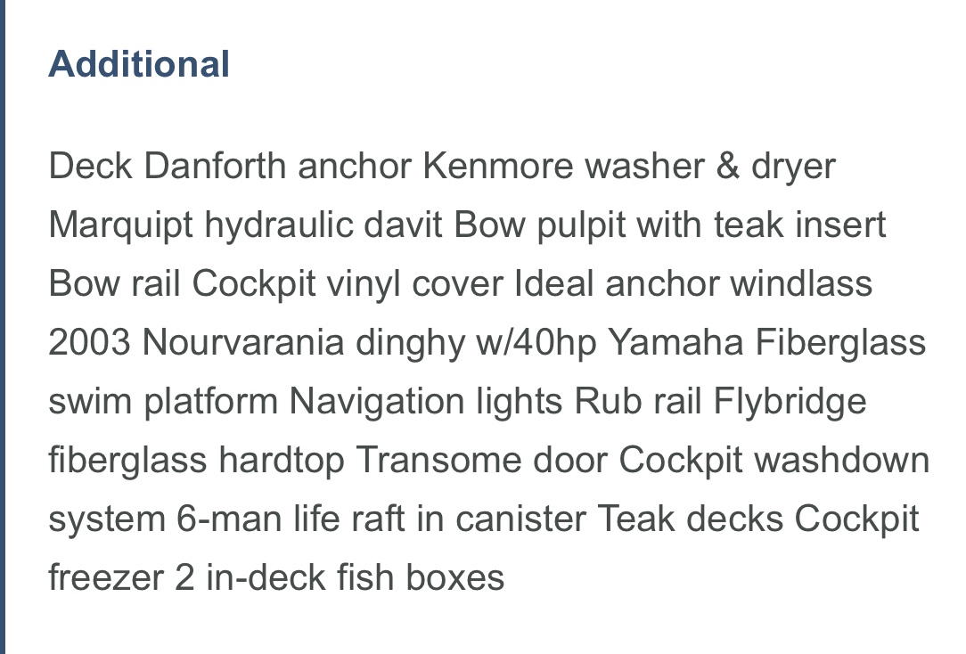

  7. RER
    RER Senior Member
    Jan 20, 2009
    1,542
    Newport Beach CA
    Specs for BIG T’S on Sold Boats says you have a Marquipt davit.

  16. RER
    RER Senior Member
    Jan 20, 2009
    1,542
    Newport Beach CA
    That was the name of your boat back in 2008 before it was sold and became TIGER SHARK II. Can’t send a link. Sold Boats is a member-only password protected site.
